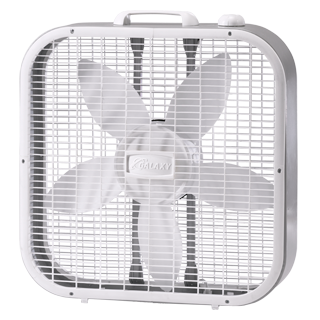

Grab a number of 2' x 2' box fans like this:
Tape 2' x 2' furnace filters to the fans.
They will really help keep dust down.
This sounds interesting - so you tape the furnace filter to the back of the fan and point the fan away from everything?
player
I use 2 filters. I put a really cheap furnace filter on the back, to catch all the bigger particles first. then on the front I put a better filter. I usually get 3m Filtrete filters for the front.
I write the date on the filters so I can tell how old they are. I use Gorilla Tape, 2 to 3 pieces on each side. I fold the tape to make a tab so they are easy to remove.
The fans come with small plastic feet. I am going to use some flat wood or aluminum to make better feet. Maybe 6" long x 2. If you knock one of the fans over they can make quite a cloud of dust.
When I change the filters I use an air hose and a compressor outside to blow out the fan.
I have 4 of them running and they really catch a lot of dust. I place them where the back or intake gets plenty of air and they are out of the way. They have 3 speeds I usually have them set to 1 or 2. The filters turn black...

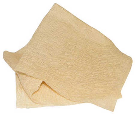

Andy D
We had the same problem until we got rid of our carpets, they were just trash and static traps.
Now we have smooth concrete floors that we go over every night with a dust mop, that takes all of 5 - 10 minutes.
The other things that made a big difference is to bushing off our tables with a clean shop brush before every job and
we go over every substrate with a painters tack cloth before we mount the graphic and wipe down all vinyl with a painters tack cloth
as it's going thru the laminator.
These should be your best friends:
