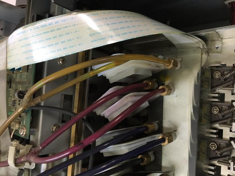

Thank u ever one for your help had to order heads over seas unfortunately due to finance but all went well I'm up and running now.There must been some fluke on those head channels,Only issue now is a air bubble in the lines but printing well just need keep an eye on it.

juf1an
I change the dumper of yellow, and look like yours. Thats ok?
