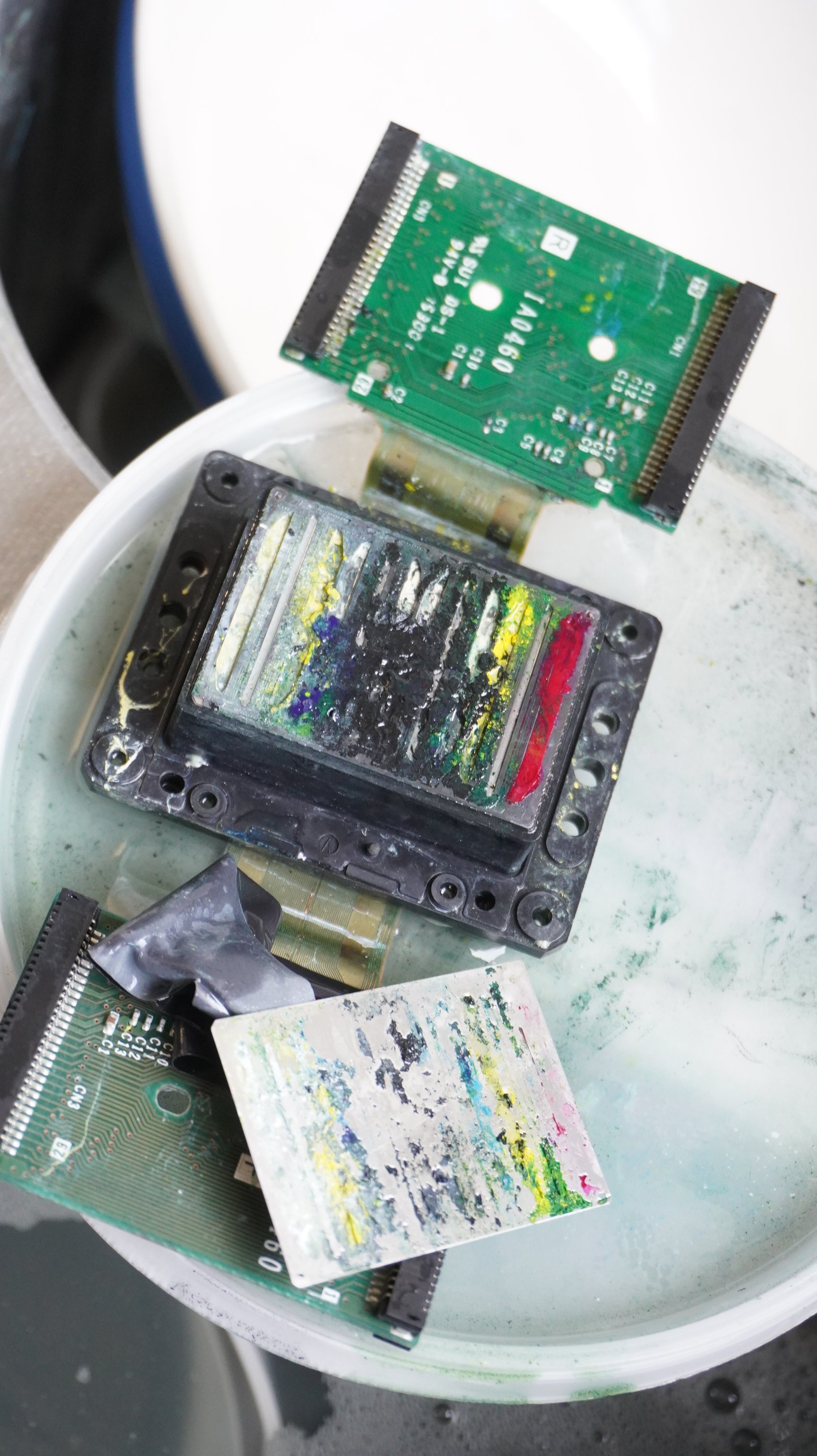

I cant say if its fake or not ive no experience but the guys feedback was great and also he sent a test video before sending it, and also i did have that printhead working but you can see the image where the cable has now snapped!

You can see the image i posted of the damaged one i opened up below, Doesnt look like their cables were the issue being honest! I bought these as non-working i must point that out again so not complaining
I think they were left so long the head dried up crusty inside hence why some channels were not working but bear in mind im doing 2 x BN20 and also i put the cables in wrong as one is a 28 x pin cable the other 3 are 29 x pin cables!

Well what happens when a MICRO bit of ink touches those tiny little gold prongs on the sides of the DX7 With Conductive INK? mmmmmm
You can see how bad this head looks like inside guys OLD INK No wonder i was doomed from the get go
