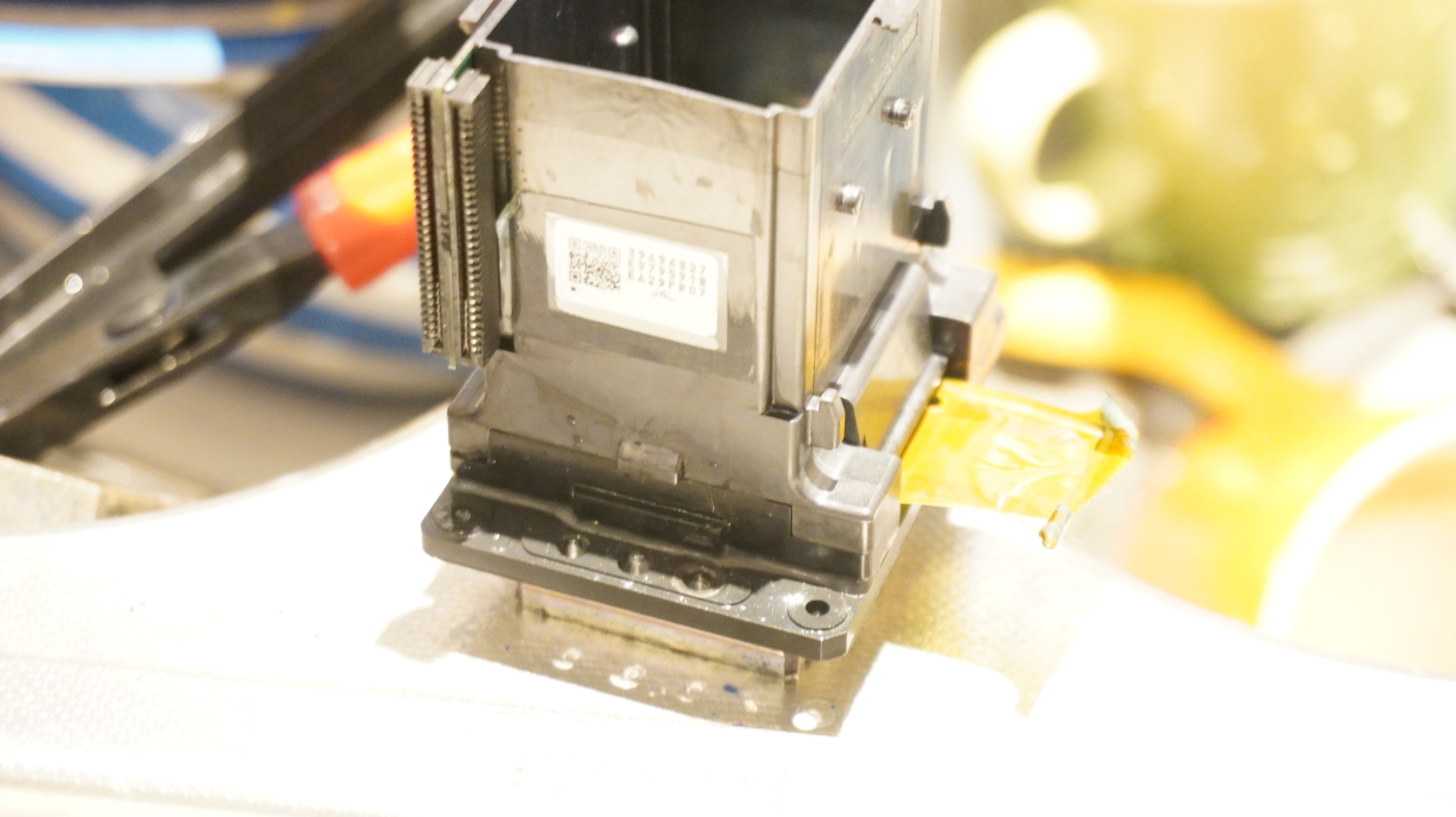

:oops:Can anyone here help me im restoring 2 x BN20 printers and worked hard on them for 2 x weeks but had some issues with cables etc so changed the printhead many times and dampners almost had it working but had issues with Megenta so i opened up the $1200 Printhead to see why Magenta wasnt coming through
Checked the head to see if water could get through the head and the magenta wasnt
Dried it off
Installed it and smelt smoke, looked carefully seen smoke coming from the printhead
Unplugged the machine
Now i just got this printhead used $1200 2 x weeks ago and im already in a fair bit of debt as it is
So i went to open it up again and guess what the fragile used Impossible to repair cable snapped as seen in the pics
If i could cry i probably would!
Can anyone sell me a DX7 working printhead much cheaper?
Id really appreciate it
Adam P.S. I'd pay shipping and of course for a working DX7 printhead

Most of china dx7 are fake bad reburbished dx7. They glue the front lasered plate in any position so no ink can drop lol see if they have 8 lines of nozzles. In my case they (2 printheads) had 6 lines. I fighted with them in PayPal until all money was returned
damonCA21
Ah nightmare ! As you have found out, the heads aren't supposed to be dismantled. Even if you could, there is nothing you can get to inside them to fix.
The problem with solvent heads is once they have had ink in them it is very risky getting a used one. If it has been properly flushed ( which can damage the head ) it may work, but if not the ink will dry in the tiny nozzles and block them, and there is very little chance of getting it running properly again.
If you can take a head off and fit it to another machine within 24 hours then it should be ok, but if its being posted and takes a week to get to you then its unlikely.
I think your only real option is to get a new head, and not a 'refurbished' one that is probably going to cause you more problems like this one has.

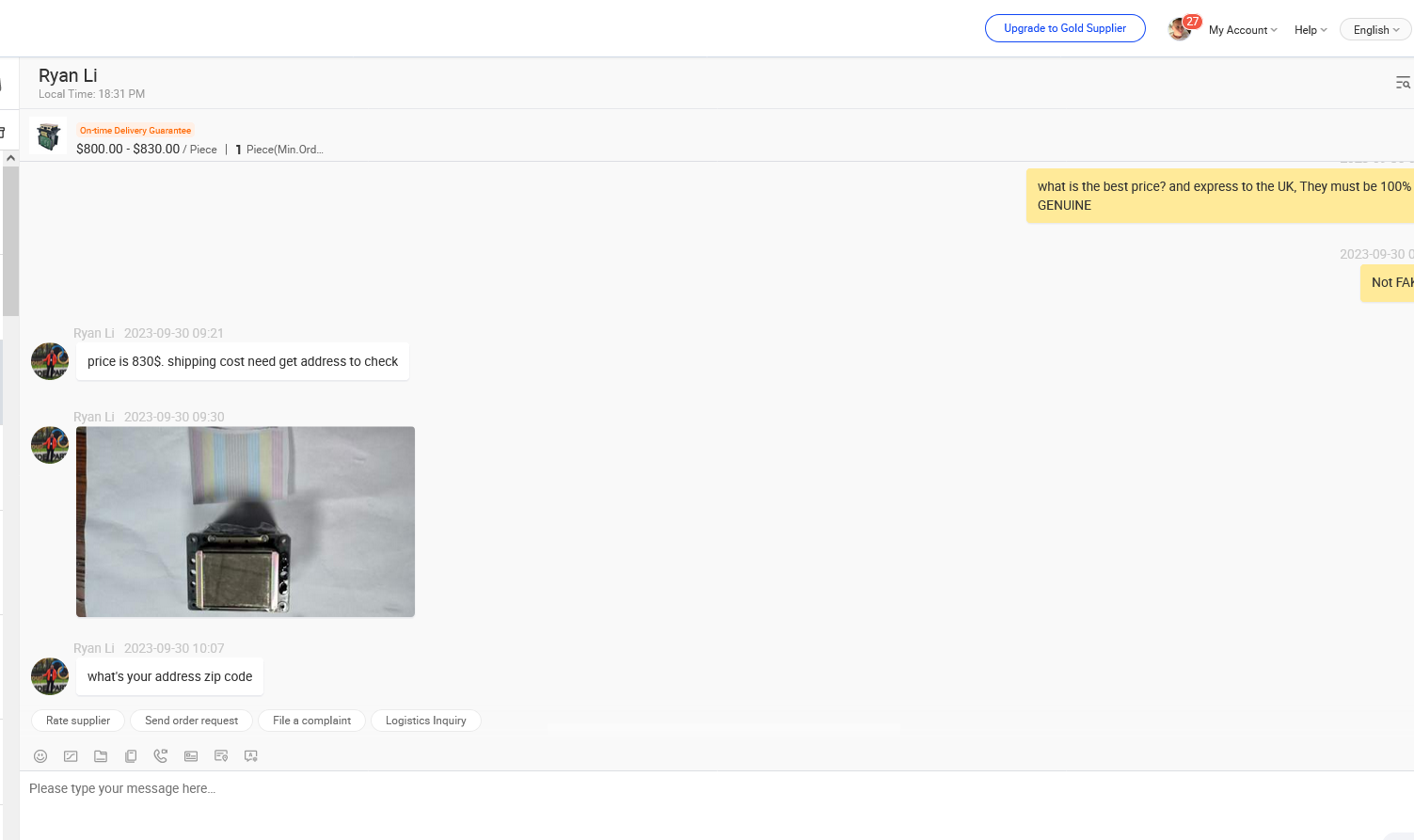

I now have 7 x days to make sure these BN20 are super clean, Super DRY, And super new cables all attached carefully and filled with new genuine ink
BEFORE i have no option to get another DX7 refurbished from China as i dont and cant and wont pay £2000 for a new one
damonCA21
Before you buy that ask them how they clean the head before sending it. That test print could have been done days or weeks before they removed it from the printer, or may not even be from that head.
If it sits with solvent ink in it for a week its unlikely to work when it gets to you. Epson test print the heads with water based ink, then fill them with a special solution designed to stop them drying out while they are on the shelf. AFAIK the chinese don't do this.
