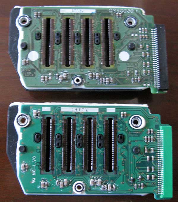

I still would want to see it for myself. The DX5 printheads have NO LOGIC on their circuit boards. Only a few resistors. Attached is something few have ever seen before, 2 DX5 heads, a Mimaki OEM IH47V one and a generic Epson IF33V with the potting compound removed exposing the entire circuit board on the head. Nothing but a few resistors. There is nothing electronic on these that could cause a machine to make a line every so often.
The only thing that could cause that would be a problem with the head, something in the printers firmware that is detecting a head with a specific resistance level, or something wrong with the printer, or Epson has added some sort of a logic chip to the board on the top of the printheads that somehow detects the printer as not being an Epson branded machine. I just do not see that last option as very likely.
The head resistance level check is what Mimaki added to the JV33 machines in firmware version 3.0 and higher. The OEM Mimaki DX5 IH47V heads have a different resistor value on some pin than a generic Epson head. This is why on a JV33 if you downgrade the printer firmware to version 2 you can use the generic heads.

Well - I cleaned them off a couple of years ago to see for myself what exactly was on the heads. The idea was to compare the Mimaki OEM head to a generic one with the possibility of in the future figuring a way to add a resistor to a generic head to allow it's use on a Mimaki JV33 with firmware 3.0 and higher (or other models with the head check implemented in the firmware).
I just never got the time to really go through all of the pins in the ribbon connectors and determine all the values and then test some. If I can eventually get the time to do so my plan was to actually add a resistor further up the line on the slider board itself that would simply make the machine think any head installed is a Mimaki OEM (IH47V green connector) head. This would eliminate the need to use Mimaki OEM heads and eliminate the need to keep your machine at a very early firmware just so you can use a generic head.
Back on the OP's post. I'm not saying Epson could not have or did not possibly add some sort of logic chip to the board on the heads. That is possible for sure but it seems unlikely. They have been known though to do all sorts of things to restrict access to their heads to prevent do it yourselfers from replacing them on their own or at a lower cost than going through a dealer.

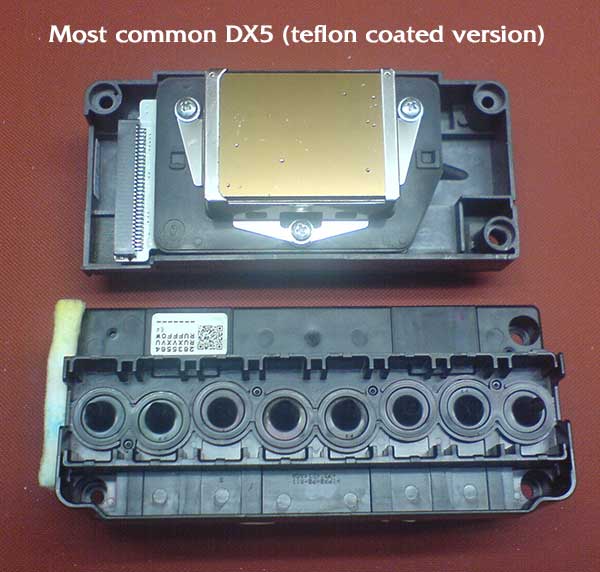

I think there is also public confusion about the versions/naming of the assorted heads Epson produces. The DX5 as we know actually is made in a couple of configurations. I do not believe Epson actually uses the term DX(X) as a designation of their heads but I could be wrong on this. All of this is conjecture and opinion on my part.
I've uploaded some images of some of them labeling them as I think the actual evolution went. I do know that what we think of as the DX5 is/was made in at least 3 different forms. 2 of them are the familiar 8 channel form that we have seen. The most common longish flat version that is used in many machines. The second primary version is a more compact and upright 8 channel version which I believe has commonly been called the DX6 but is in all actuality the exact same spec as a DX5, just in a vertical more compact package. On this version each of the 2 head cables come out of each side instead of both from the same side and these use a different style damper. There is also a 4 channel half size "DX5" head used in quite a few smaller printers. I'd think the compact upright version that many have called both DX6 and DX7 would be electrically compatible with a DX5 machine as long as you could make your two head cables reach each side and you would figure out a way to mount it to your head carriage.

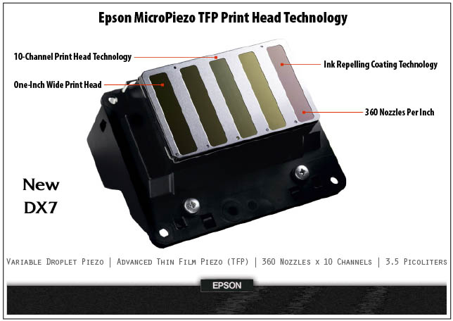

Epson's newest head which is believe is what many are referring to as the DX7 is a different beast and there is no way it could be physically or electrically compatible with a DX5 machine. The newest head has 10 channels and is very obviously different with the main nozzle plate cover having dividers between each of the pairs of channels. The firmware and much more on the machine would have to be quite different to work with the new 10 channel head.
Again - these are just my thoughts on these. I could be totally wrong on all of this. As far as the newest DX5's being ripped out of Epson desktop printers having a blank line printing every so often.... I just do not know. Maybe they did indeed modify something on the newest batches of non-OEM DX5 heads to prevent them from working in wide format machines and DTG machines which is the most common reason they get ripped out of brand new desktop printers. I'm very confident and certain they still make OEM heads for sale directly through OEMs like Mimaki which will work perfectly fine though. You will just pay three times as much for the head is all.

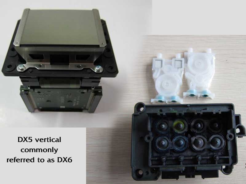

The first revision of the vertical head had the same drop sizes as the horizontal head. Mutoh used this first generation in the ValueJet 1618 and the ValueJet 1608HA and 1608HS. I am not sure if electronically they are the same though and have no idea if they are compatible with a printer that has the horizontal heads. I highly doubt that they will work.
The current revision of the vertical head has two additional drop sizes and is definitally not compatible with any of the older horizontal heads. Mutoh uses these heads in all of the current ValueJet printers (1324, 1624, 1638, 2638, RJ-900X and the upcoming Hybrid 1617)

it is near impossible swap DX5 head to DX7 head.
you need swap all the boards and cables, capping, dampers...
it is same to swap a new printer
And, Epson change the DX7 head too
So, if you want buy DX7 head, have to confirm if it is old version head.

I have just checked with Mutoh on this and the actual head itself is the same part in the printers I originally mentioned. The only difference between the 1638 and the 1324/1624 is the mounting bracket used to mount it to the carriage but the actual head is identical.

Epson DX7 head is different from Mutoh DX7 head.
Epson DX7 head is F189010 head, Epson start change it months ago, new version can not work like new DX5 head.
Mutoh DX7 head is made by Epson too, but it is professional Mutoh head OEM from Epson, it is original Mutoh head.
At prsent, from Mutoh DX6 head printers, can only use original Mutoh head. There is no compatible Epson head for them.
