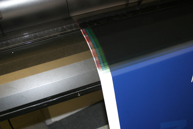

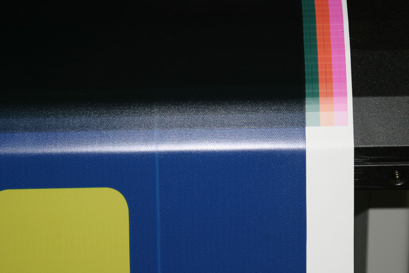

OK no more Error message but WTH is this now?? Im shutting off every thing and restarting every thing.. I hope my main board ddid not take a crap!

In your last image post it could be as simple as the print head hitting the media . . .
make sure the media is not curled and check the height of the print head !
