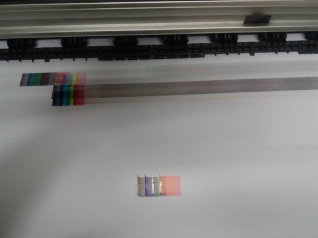

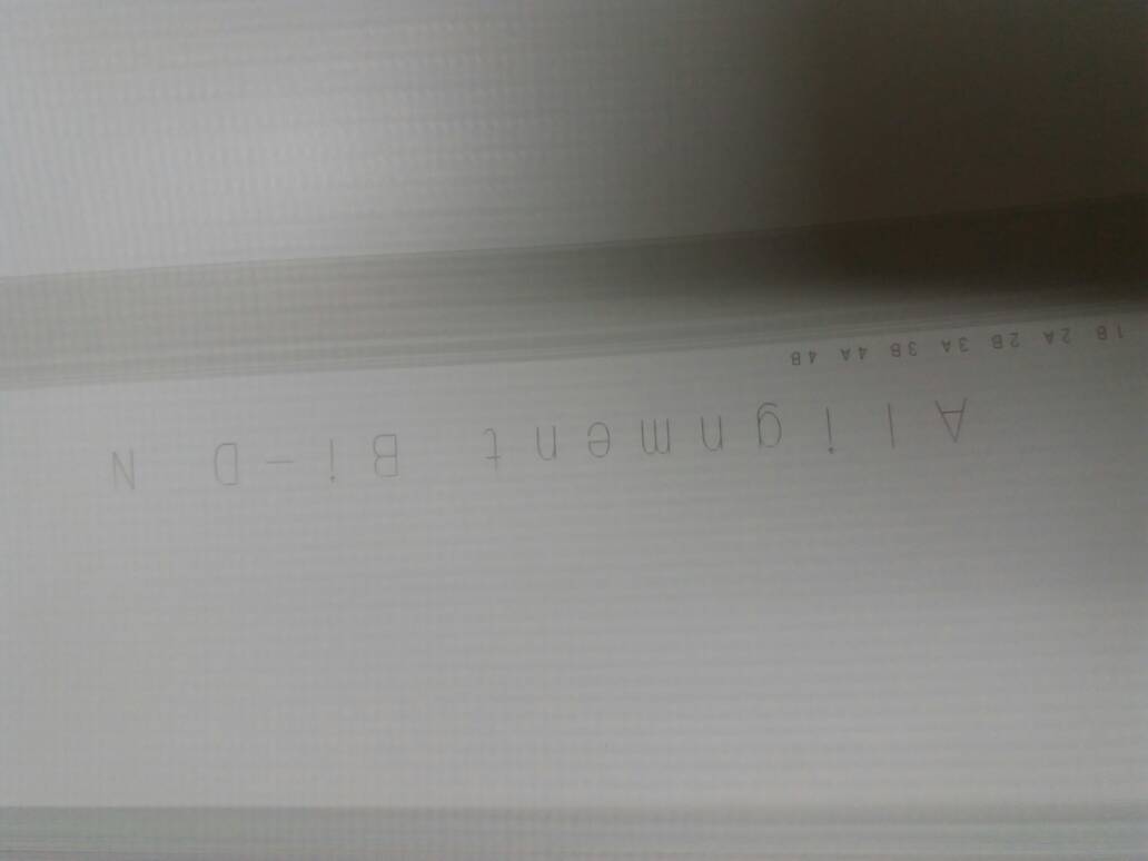

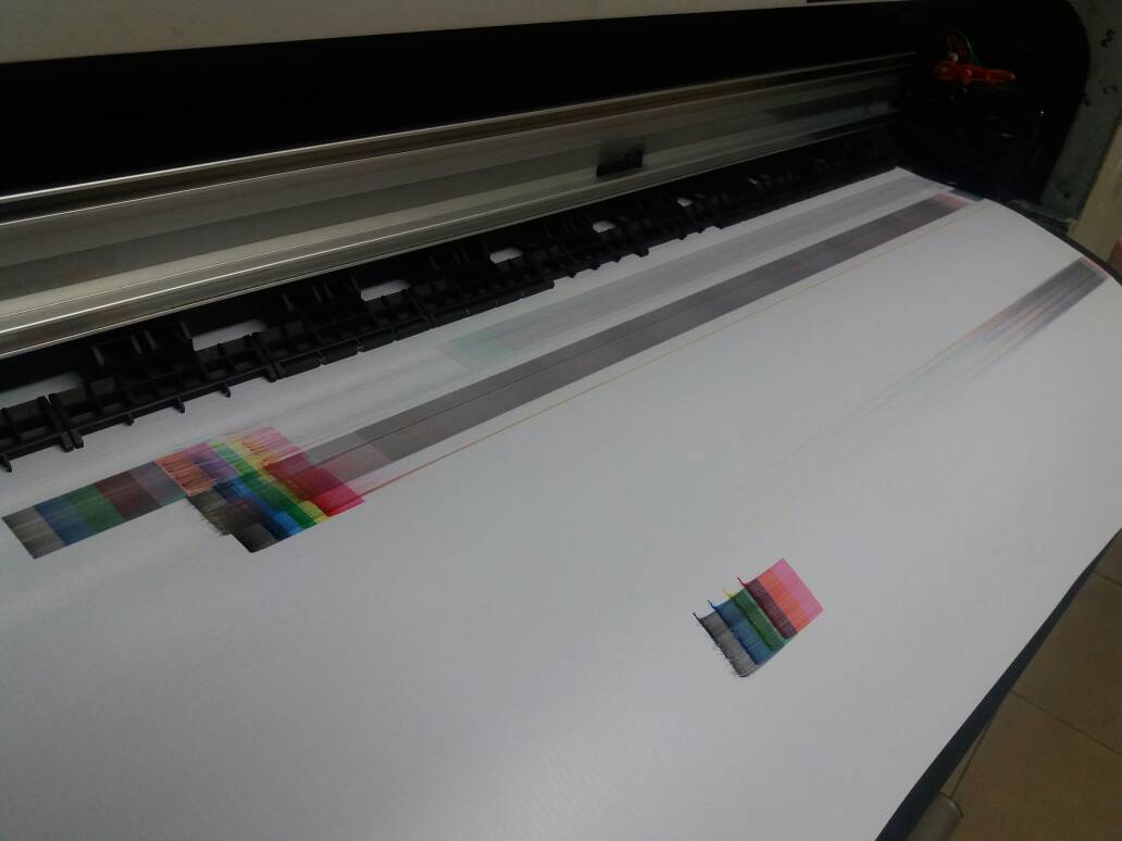

hello my friends i know this is an old thread, but i have the same problem with my vj 1204, check the image, i buy a new print head whit a flat cables new and one kit of maintenance, i try print but E074 err Current Cr and the carriage stop in the middle of the printer, and later of reset the printer send a new print and i have this...
See this
print and after 11 pass print a band of black combined just like that,
please help me... i don't know what happening.
tried to run another print, just to see if anything changed. The print was coming off nicely for about the first 4 feet.. then as I was leaning over the exposed carriage as it was printing, I heard a high pitched hiss, and the bands started laying down immediately after that noise. I ended the run in flexi and cleaned all the overprint ink that was layed down to start another try.. this time I heard the high pitched noise after just one pass... there went the bands. Ha.
Anyone ever have this noise from their printer?

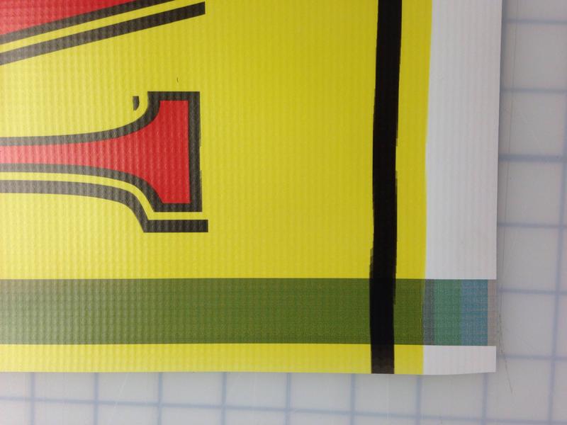

I am hearing harsh grinding type noise when the print head gets by the capping station during a normal printing pass as seen in the attached pic note the shifting on the media.

I had the same error. My wiper was stuck. I cleaned it and now it's ok.
