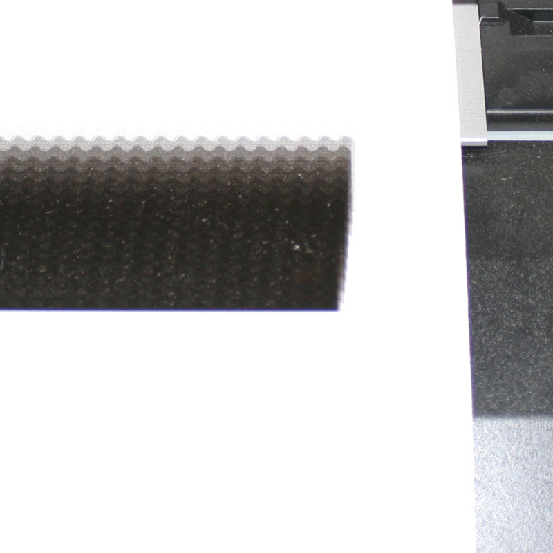

Hello all,
I am getting a " E074Err CR2 Current " error on my Value jet VJ1204.:banghead:
I am hearing harsh grinding type noise when the print head gets by the capping station during a normal printing pass as seen in the attached pic note the shifting on the media.
I do not have a maintenance manuel for this model so I can't tell what the code means.
I want to see if I can figure this out first before waiting for GEI to get out here I have 30 some odd banners to print among other signs to make.
Thanks,

Derf
Sweet! Dude you rock!!!!! you just saved my ass! I cleaned the T fence and she prints fine again!
