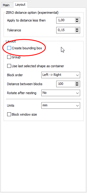

Don't know for sure, but I did find this, there is a check box to enable/ disable bounding box. Otherwise it could be the container size.

Just ungroup everything first, if you want them nested properly.
Otherwise it treats what you've grouped as 'set in stone' and won't pull them apart.
The bounding box is the plate size they have to be fitted to.
