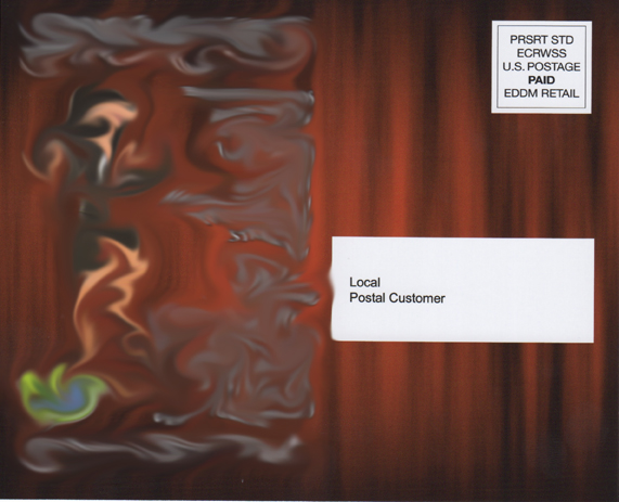

Acceptable common printer friendly sizes:
6.5 x 9
6.5 x 12
8 x 6.5
8 x 10
8.5 x 11
9 x 11
9 x 12
Example of how to prepare the card:
Only other printing is concern is sag. If you use paper too thin and it sags too much it could be rejected.

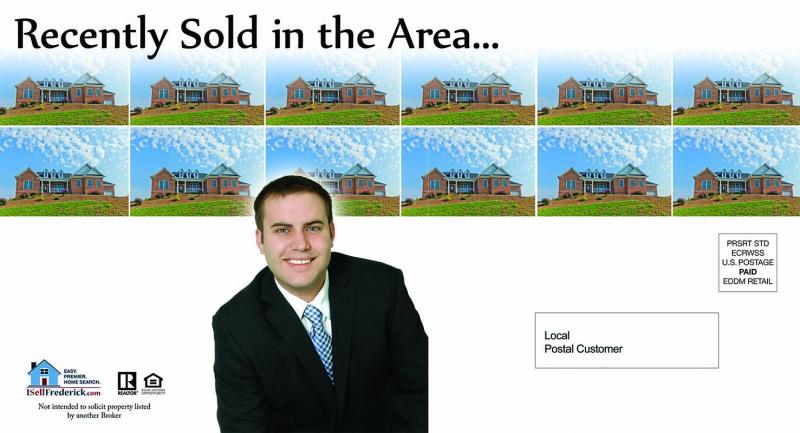

so something like this would work fine? (not done... just giving an example) :)
I assume that I take it to whatever post office where these will be distributed from...
they will be printed on 16pt card stock, and UV coated on both sides.
bikecomedy
If your assumption includes you dividing them up and labeling them for each carrier then yes. The online system has a form to print for each route. Count them into multiples of 50 or less and rubber band them and label the stack for each carrier.
fdkss03
yes, I would bundle into stacks of 50 or 100... rubber band the facing sheet to them... and deliver to the post office... paying them... not the online USPS. That way the end of the day it represents them... not the online entity which doesn't benefit the local branch.
