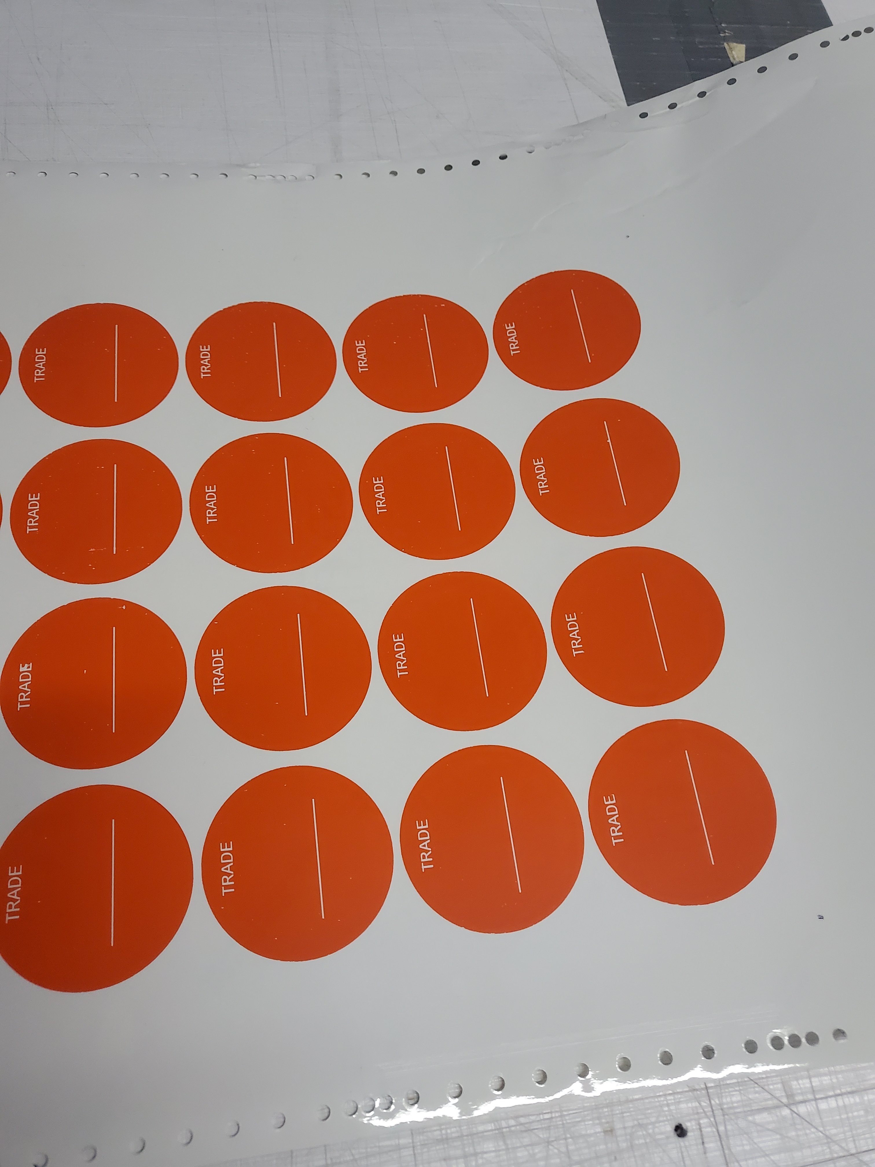

I'm having loads of trouble with the Edge 2

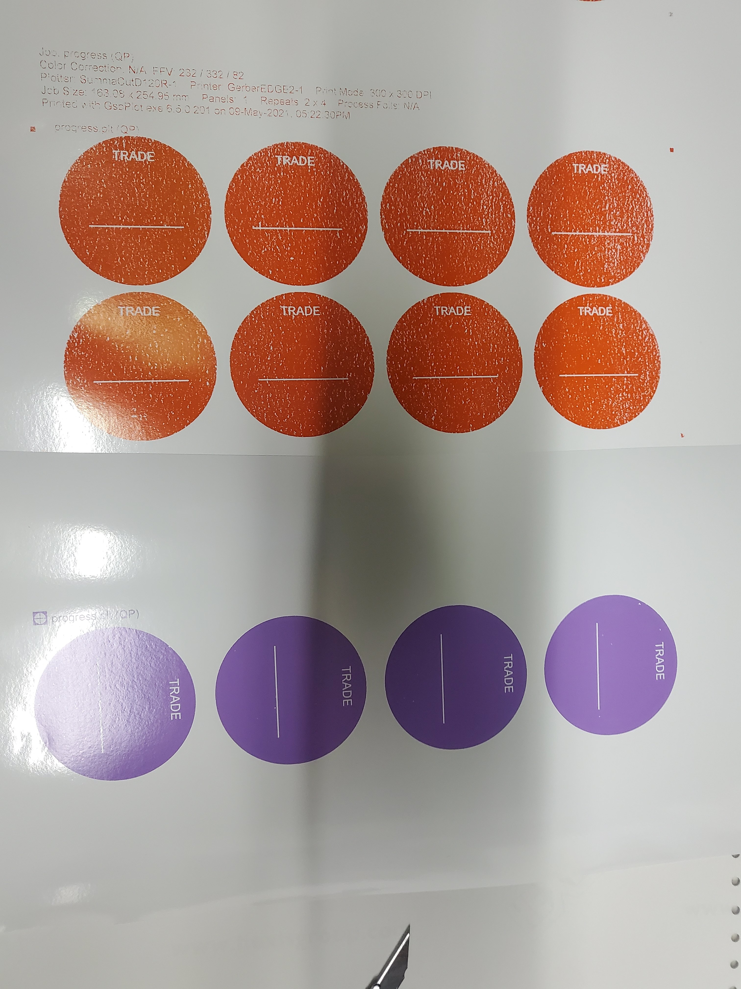

I've attached an image of the same material both in Edge 1 le and Edge 2
The 2 is all patchy and nothing I change makes a difference. When you print abrasion guard its all patchy aswell
If the vinyl is 100% glass smooth it's OK
Any help before I throw it out for the scrap as it wastes so much material it's almost useless

Was using hexis removable. In omega 6.
Used s5000 today. Put the yellow down fine. But over print was all bitty and then tried to uv guard it and that was patchy aswell
Edge le perfect everytime any material

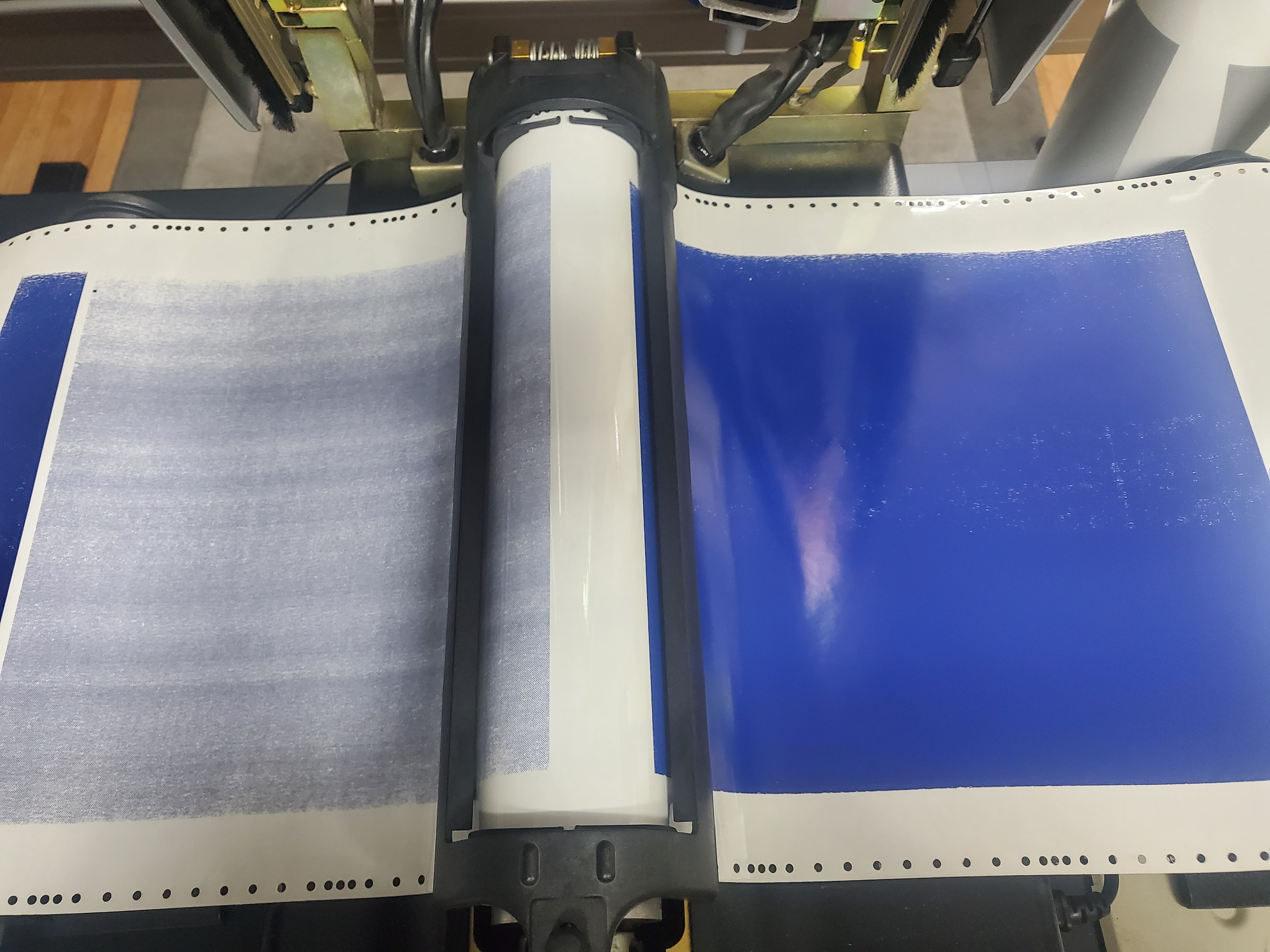

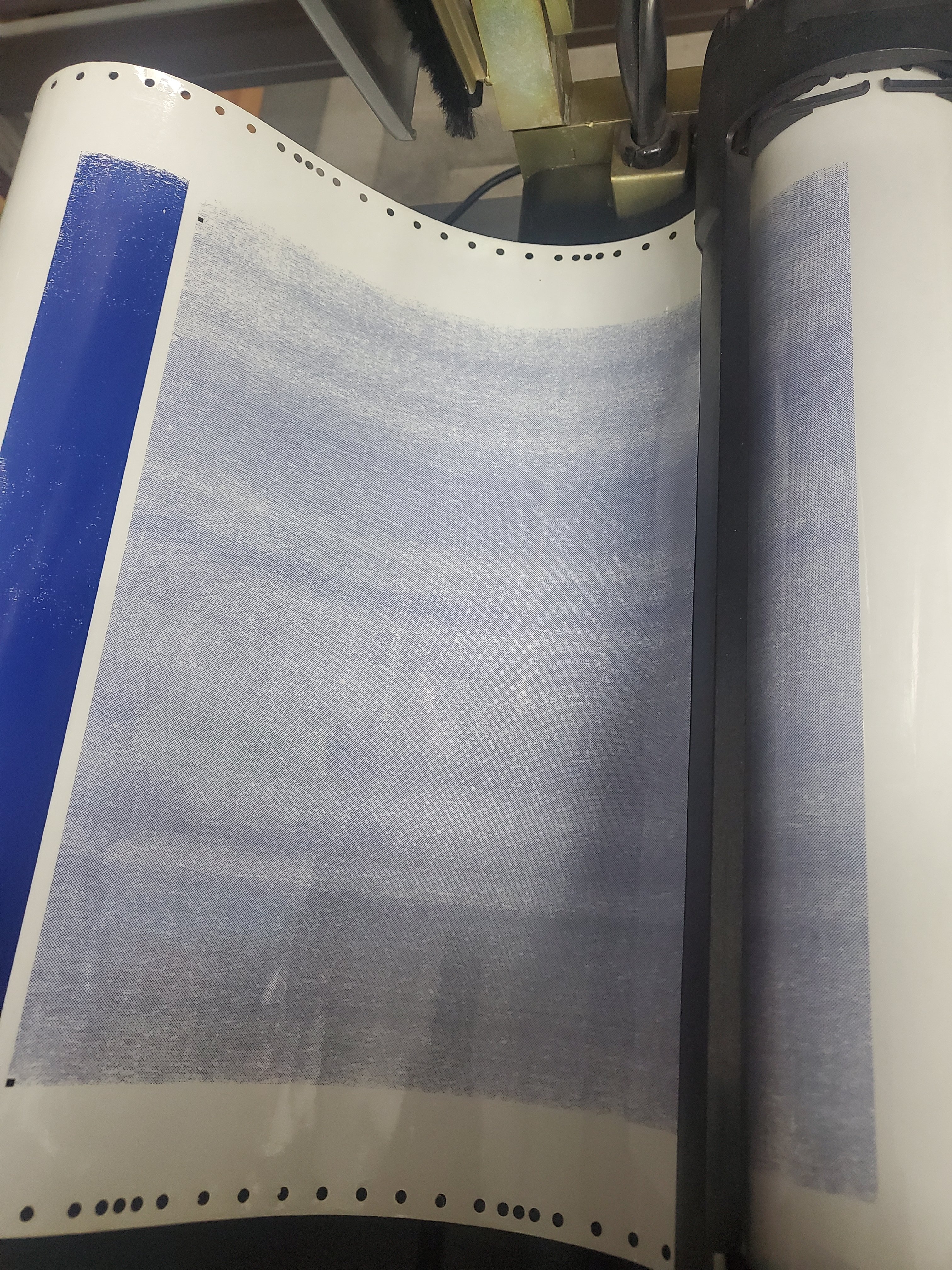

Hello mate.
Here's the attached print out doing what you said
The other ones are just what I printed aswell

I don't see the print info on the cobalt blue 50% prints so I will assume you printed on 220 with 220 settings 300x300 and if thats the case something is 100% not right with your Edge 2. Time to have Spandex service look at it, could be head pressure, voltage or the head itself.
