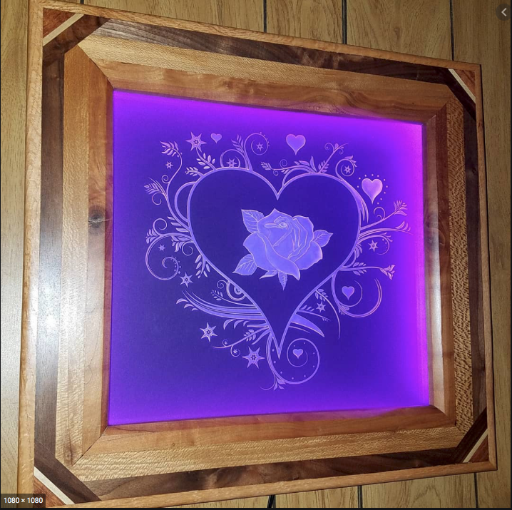

Okay sorry for the delay, it's going to be roughly 24" x 36" and it's going to be something he turns into his insurance company to pay for. I have attached a picture that pretty much shows the same concept I'm going for. The one he had was always one color whenever he turned it on so I'm not so much worried about the ability to change colors.
