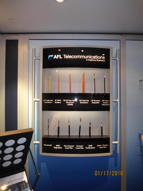

the art is simple white text outlined in Illustrator with vector white logo at top.
Thought about cut vinyl and would probably work great if it was applied to front of acrylic, but since its face applied to the back it needs to be single surface or there will be adhesive voids and look like pi$$
See attached pic of original display box. The logo is no longer blue.
Black strips are 24.375 x 6" - should have specified that in first post

I don't understand what the benefit would be to printing them ... you still need to apply the adhesive film to the acrylic without leaving any defects. I've done hundreds of them on a second surface and hundreds more on the inside of windows without defects. An occasional defect gets removed and replaced. Therefore I always charge more for second surface applications.
As a first suggestion, I would recommend using translucent black which has a very smooth adhesive surface designed to give you great results. Also use a wetting solution to insure an even, defect free application. Then just finish with an appropriate paint for the blue and white such as Lacryl or Grip-Flex available from most sign supply distributors.
The other way to go would be to cut a paint mask, apply it and paint it all with either Lacryl or Grip-Flex. The paint masking films use a low/medium tack removable adhesive and work very well for the purpose you intend.

I think cut vinyl would work.
Cut the white voids out of the black so it is the first material on the inside of the acrylic.
Use solid white on the backside of the black to fill those voids.
If you are worried about that halo effect with stacked vinyl that is reverse mounted use 2mil premium for both the black and white.
If it is still a problem cut the lettering out of the white with a very small color trap to allow it butt up tight against the acrylic inside the holes in the black and still keep any gaps between the two from showing up.
