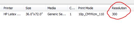

ProColorGraphics
I hope you filled out the survey HP sends you appropriately. :) My tech from IT Supplies was great. I also downloaded the IJ35C profile, but made my own 12 pass as well. I am using Caldera, but I would think you should still get a good print. I haven't tried the other print modes to see what they look like.
What is the size of the print (width x height) that was posted? Based on the image file (which is inexact at best), it looks to be very small (less than 3 inches wide x 1 inch tall).
On the Latex 300 series, I would say that this edge definition problem at very small scale is related to the resolution of the raster data set that is sent from the RIP to the printer. In Onyx, using most media profiles, the default resolution of the data is 300ppi. This can cause modest, but noticeable edge definition problems in very small images, particularly noticeable in small type (< 8 point).
The solution is simple - to build or use a media profile that renders at 600ppi, which is 4x the resolution of 300ppi. The extra data in the raster data set allows the printer to produce a cleaner edge on very small or intricate jobs.
This setting is defined in the Print Mode list box in ONYX Job Editor module.

dan1942
Ok I am lost here I can not find where it will let me adjust the print mode to 600dpi all the options I get is whatever available pass modes there are for that specific media in Onyx. I checked in job editor and tried to edit a quickset.
Thanks for your time!

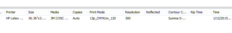

dan1942
ok here is the info from that print it says 300 so I need to build a profile that will allow me get it to 600ppi
