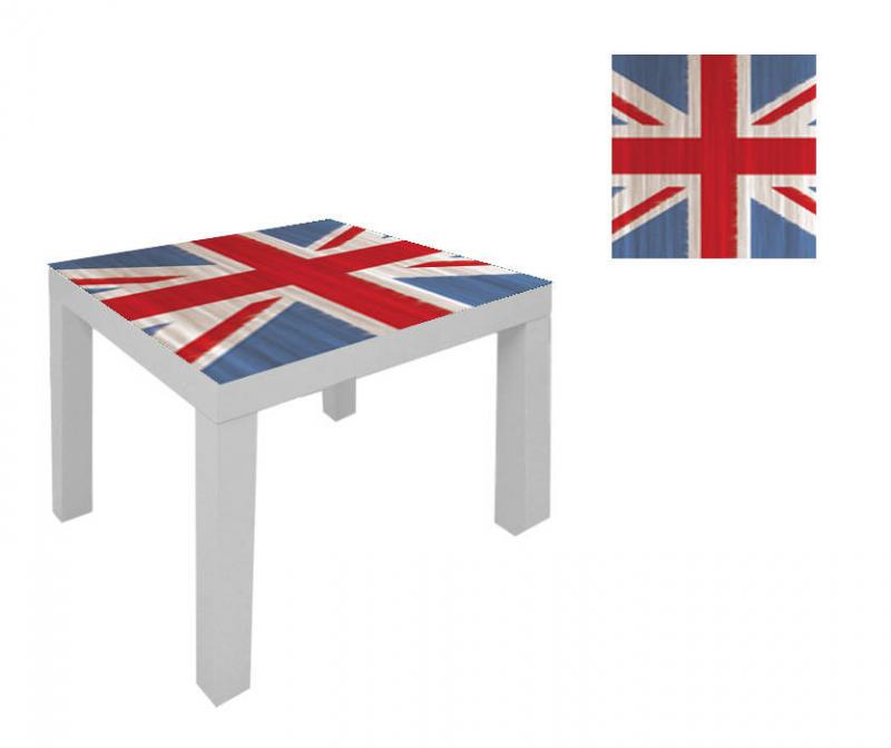

I find picture what I want to do. Like u see flag on the right is flag same as flag on table. But it look like it is "stretch" on table.
When I try with powerclip I lose some parts of picture which I want to put on table.

It doesn't look like you lost any of the image to me, everything is there, just at an extreme perspective.
I don't use Corel, this is very easy to do in Photoshop using the TRANSFORM, DISTORT tool, with NO loss of any of the image or you can crop if you like.

In Photoshop, you use layers, and just add the flag image to the layer above the table, then using the TRANSFORM DISTORT tool, you drag each corner of the flag to the corresponding corner of the table, making the flag image match the perspective of the table, without distorting the table image that is on it's own layer below.

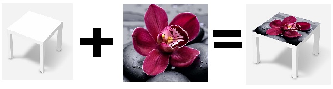

WOW...
photoshop is great. 5 min. of work...I was trying to do ths in corel for about 5-6 uhrs!
I like it alot :toasting:
Thank you one million times.
And this is result.
