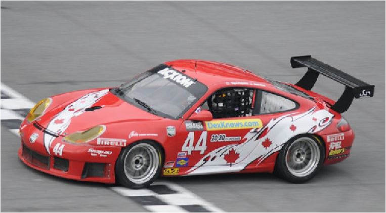

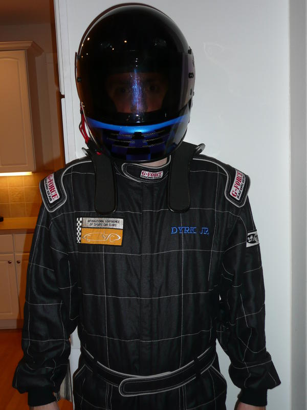

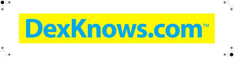

Cadartist
We ran into this problem for an Daytona driver who was sponsored by US Dex. They wanted a big logo on the back and the front but there was a zipper in the front. We used a fire retardant thread with color as close as we could match on a fire retardant yellow fabric and made a full patch for the back and a split one for the front. I hand-stitched it on so the stitches would only go thru the first layer of his suit. Sorry, but I don't have a picture of the finished suit because by the time they came to us, it was a super rush job and his wife had to take it to him because he had to leave before it was ready.
