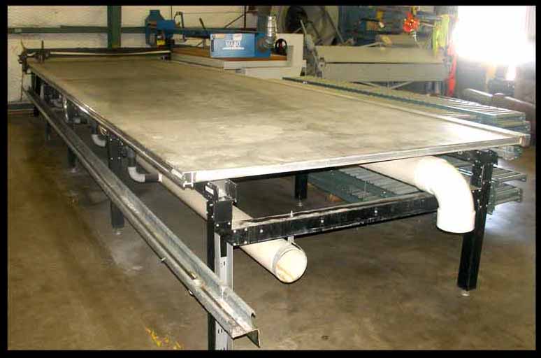

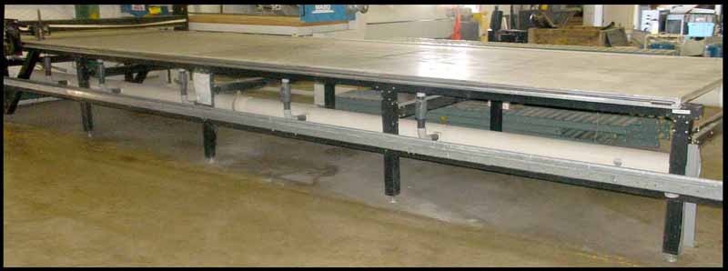

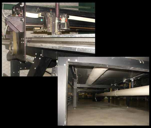

i bought this ex-cnc laser table today it's 7'x 24'. i'll shorten it into a 7' x 14' flatbed printer.
artbot
we will see! actually there is a good chance that hp latex will be a top experimental ink too. i'll just heat up a spot of aluminum and print a test. if it works, i can put an IR bar across the font of the gantry. with the thermal head all you have to do is match cps and boiling point. the boiling point or head temp can be adjusted so it sounds plausable.
the table is a very serious vacuum table so i should be able to control buckling. no matter what ink i put in the printer, the heads only cost $8 each. still mostly it will print varnishes.
