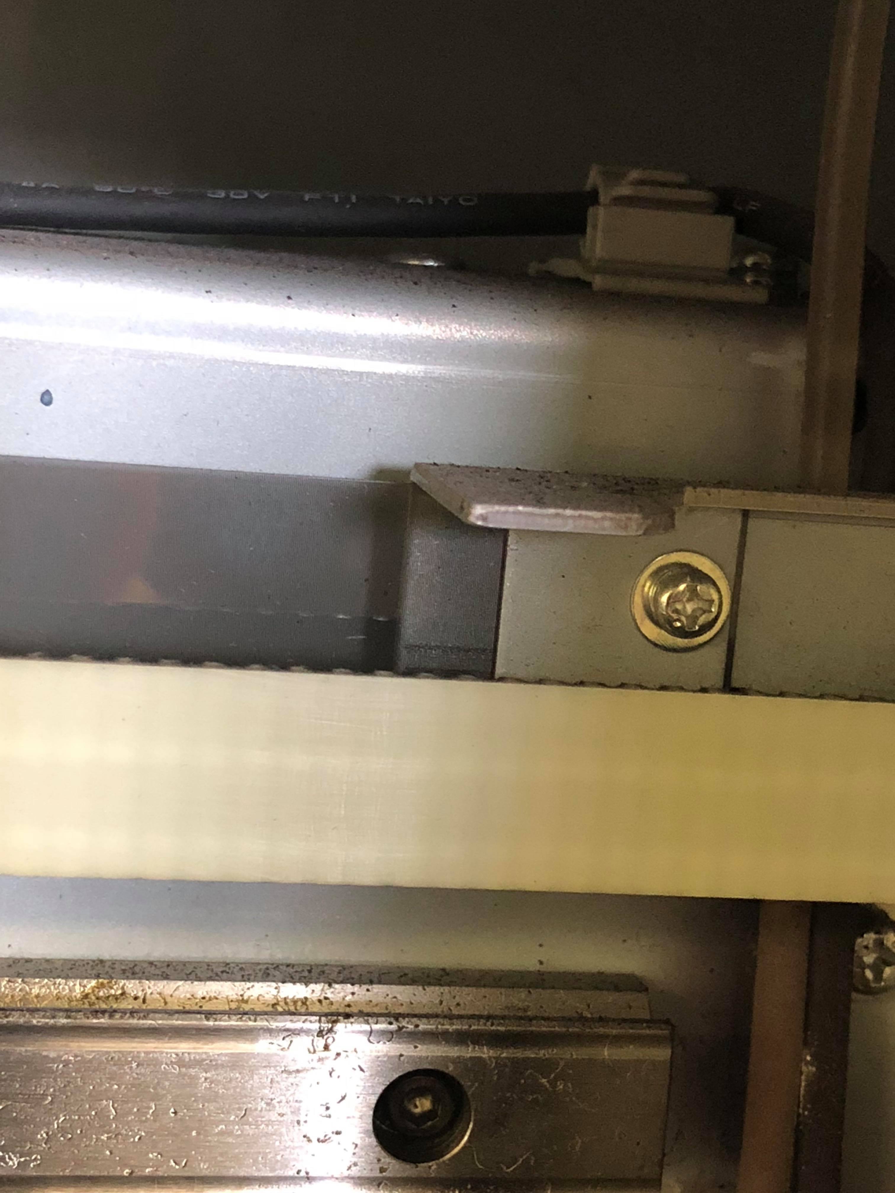

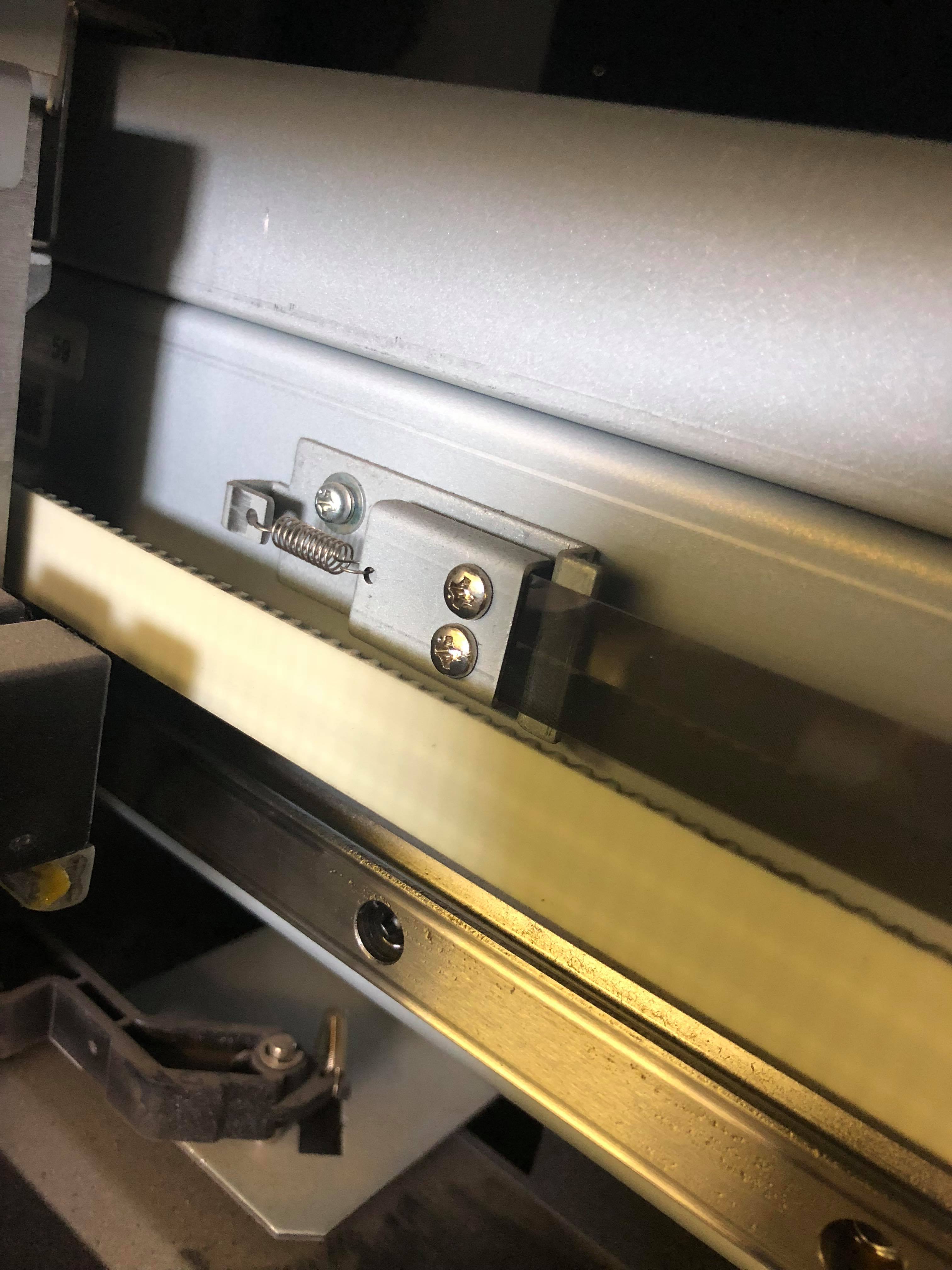

Here's a pic of each end. I put the had near the middle and took the cover off when I did mine.
