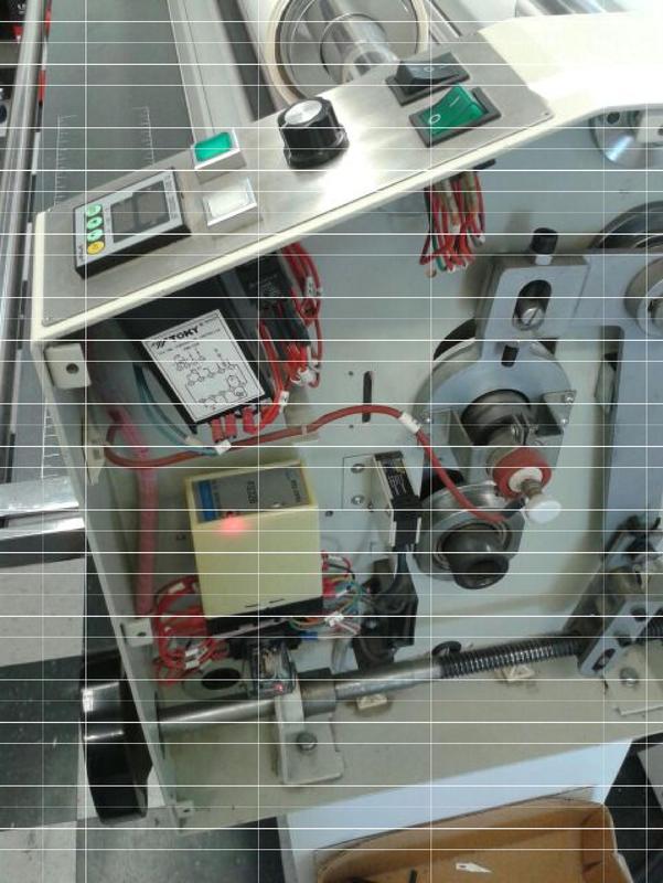

We have a 65" Enduralam Laminator with speed issues, as soon as we turn the speed knob clockwise the machine kicks in full speed. normally you can gradually increase the speed by slowly turning the knob clockwise until you reach full speed (which is very fast), but know it just goes full speed even if the knob is only slightly turned.
In the picture you can see I removed the right side cover and the speed sensor can be seen with the light on, seems ok but then again how would I know,is there anyway to check if is operating properly? help anyone?

Thank you, i pulled the side of the laminator off and got some info off of the potentiometer and ordered a new one, i guess if that doesn't fix it, it'll have to be the speed control modue pictured in hitechsignny's image he posted above. Thank you for the help so far on this issue

After replacing the speed control potentiometer, it was still doing the same thing, zero or full blast. I then popped the speed control module off and took the plastic cover off and part of it was burnt where it got hot/shorted out or whatever. It wasn't damaged too terribly so I soldered the wire back into the spot it initially was connected to and sure enough, works perfectly again. Just wanted to follow up on this thread since the owner of the thread never did or never did respond to my message.
