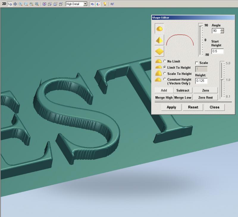

3dsignco
Got me thinking,Does enroute have a shape editor. You can adjust the roundness by putting a limit on the amount lofted.

Enroute DOES have a shape editor.. BUT, so far I could not get anything near what the roundover bit does.. I tried masking I tried adjusting by 10 degrees on EVERY object.. I literally tried everything. I really don't think there is a user-friendly way to make it work.. I have come up with some VERY interesting designs though.. So, I guess in the end: I learned.. Just not what I wanted to.

so, was my suggestion one of the things you tried? If so, what did you end up with?
Nope.. I can get pretty close, but it looks like garbage once routed. I have been doing the whole job on 1/8" ballnose. There was a short video done for me by the Enroute tech down in Oregon that did it his way, but still came out to the same thing I get each time.. A half rounded letter.

This is EXACTLY how to do it.. One of my buddies over @ the Enroute forum created it for me..
