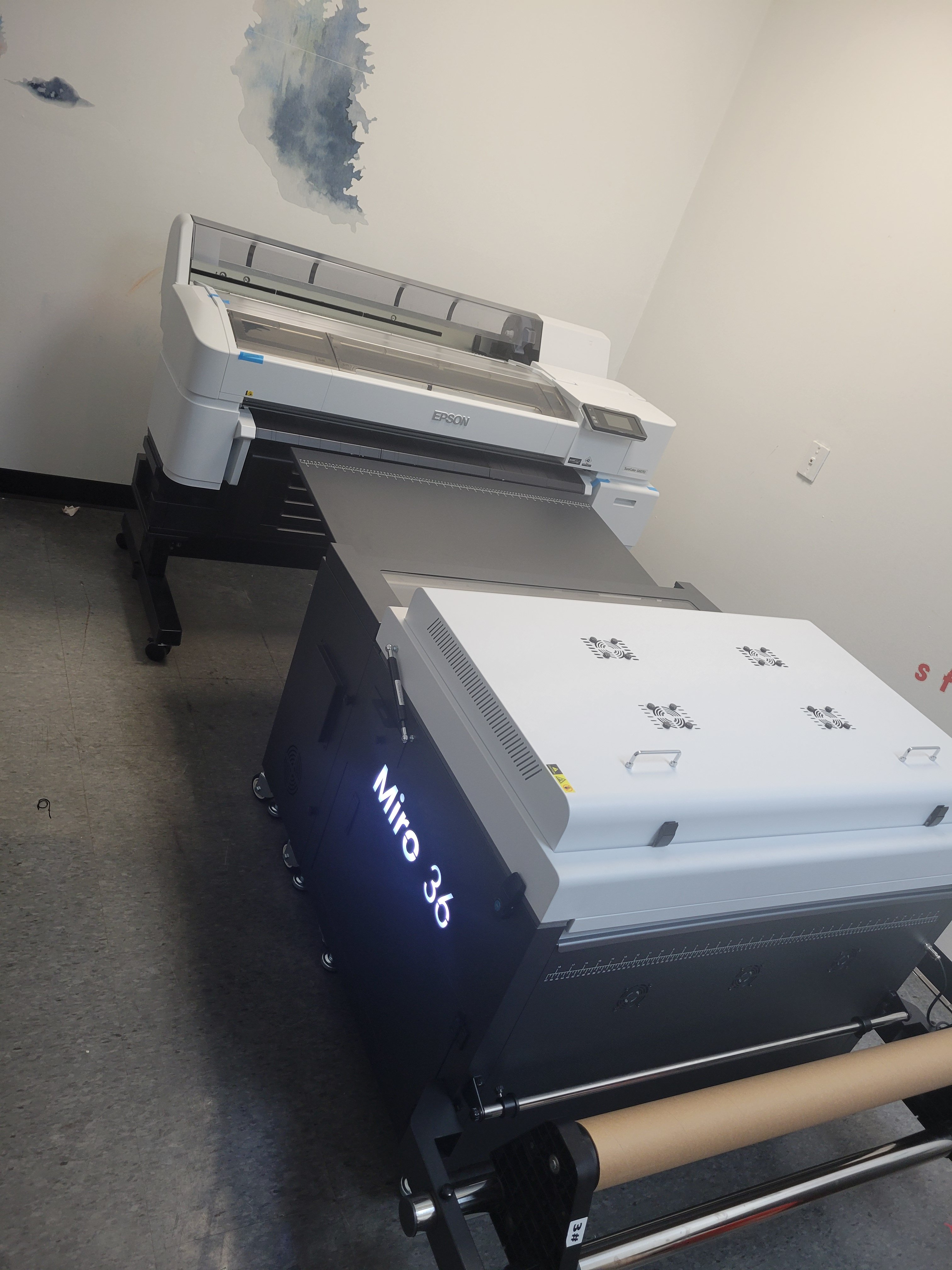

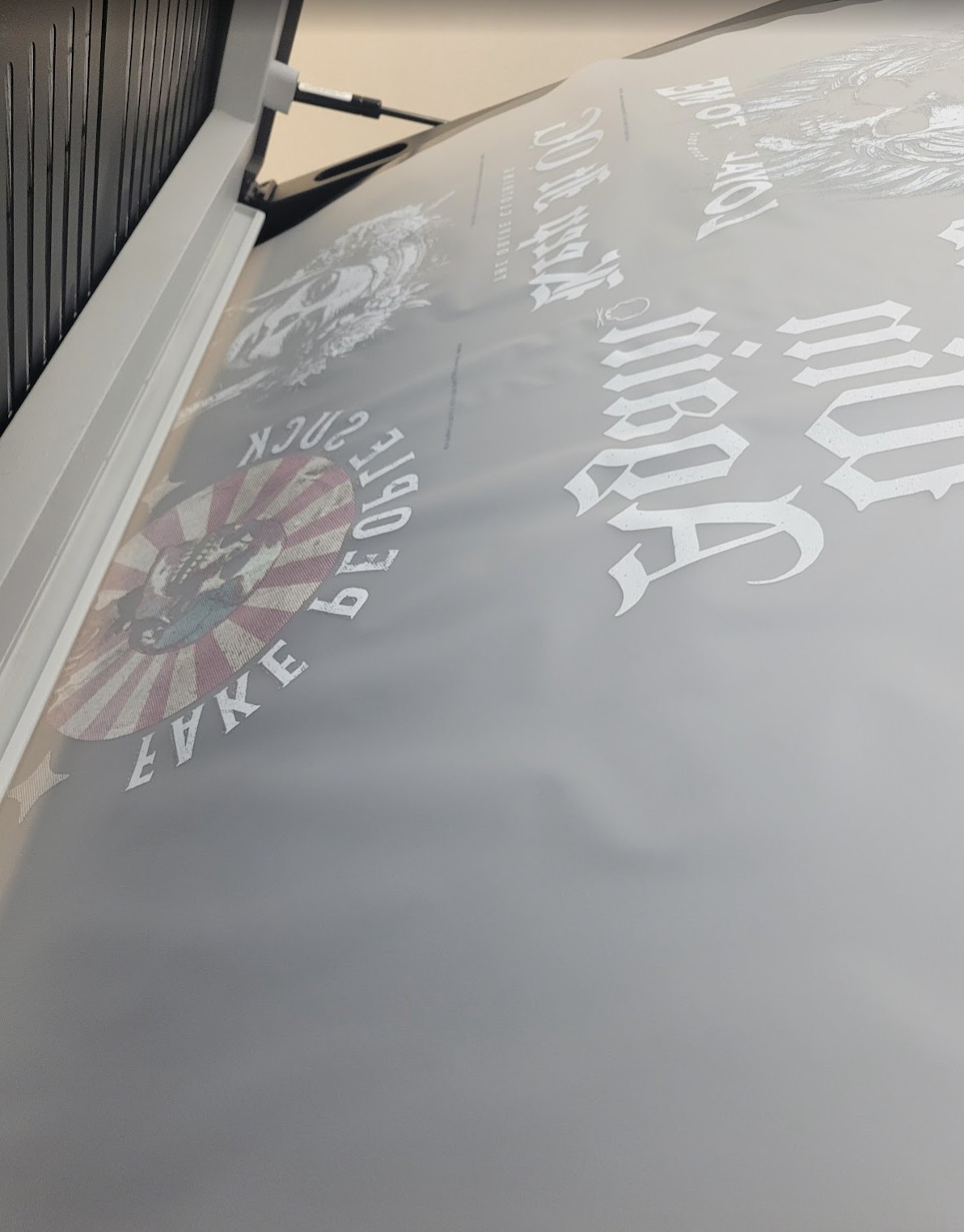

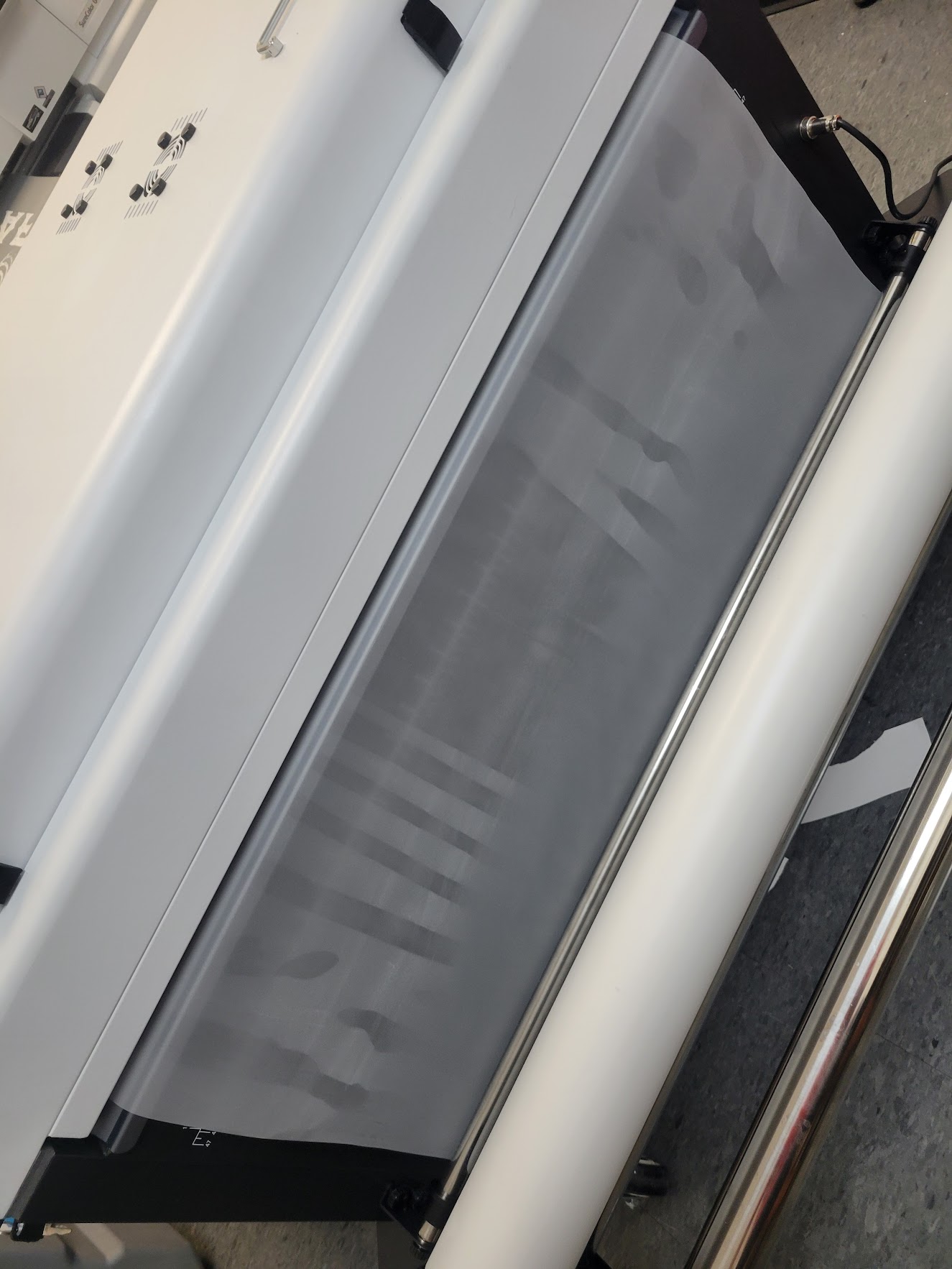

Good luck with the Miro. I'm experiencing curing problems. Poor design without top heater.
Returning the miro and purchased EZ jet. EZ jet will arrive next week

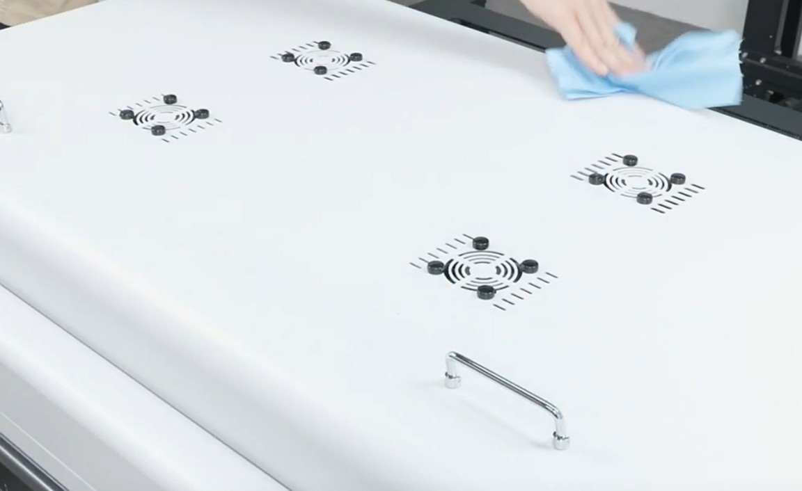

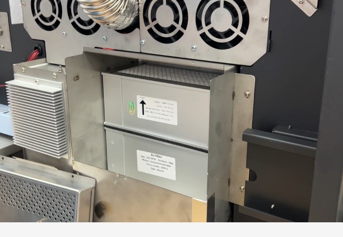

The filtration/design of the filtration system is bad also. can't be around it for long. The filter exhaust fans develop oil build up on the top cover fans meaning oil is getting blown out past the filters.

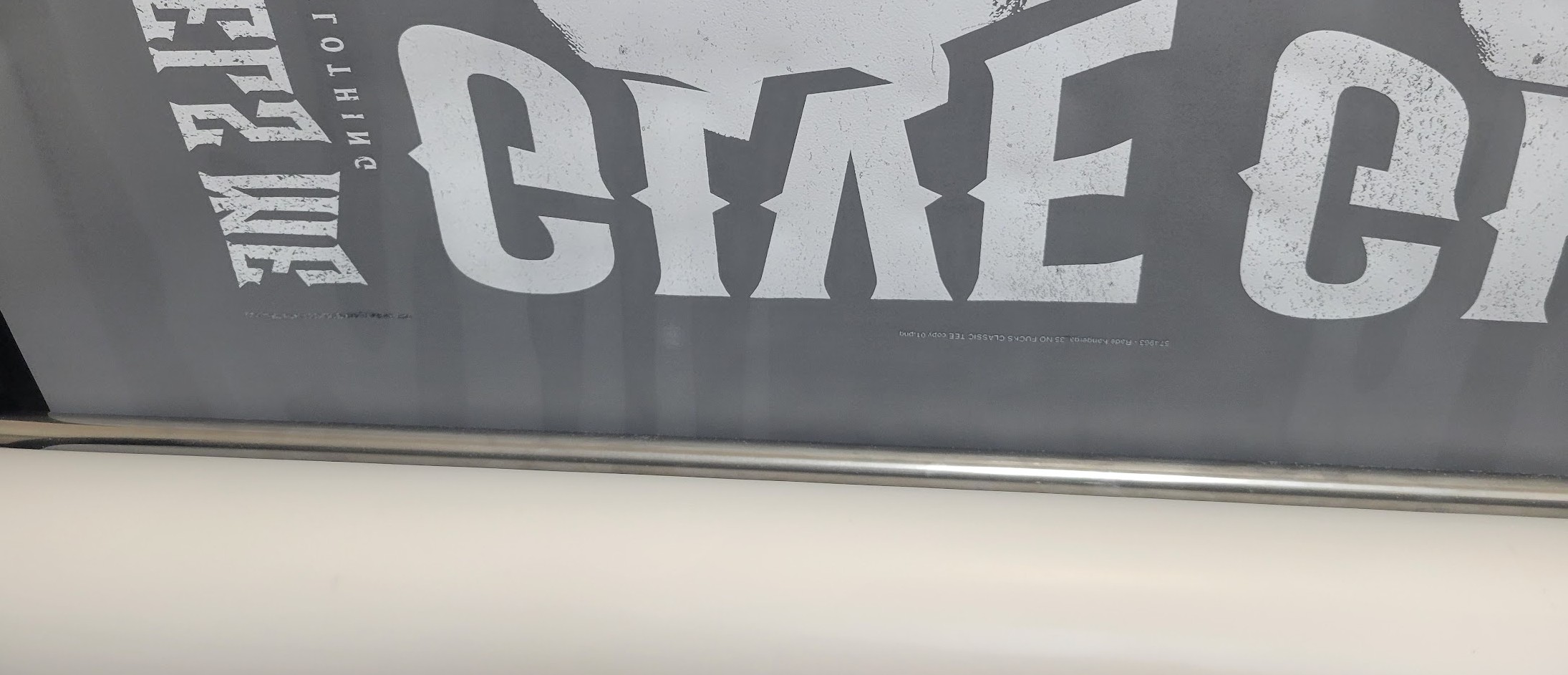

The poor curing corresponds to the air vent pattern.
If the media cups or tunnels in the heater just a bit, you'll get under-cured spots as the design relies on media making perfect contact to cure due to lack of top heat which dtf station says they removed "due to safety reasons"
Now my set up sits awaiting the new shaker that has top heat and better filtration (oil collection)
Be sure to watch for issues and let the dealer know if you notice anything. I was told there are only about 15 Miro 36 in the field right now and they all were just fired up this week as people started receiving ink. We're the first ones to test this shaker in a production environment
Luckily the dealer agreed to take mine back without hesitation

pay attention to how much oil collects past the filters, you notice oil buildup on these fans even on the outside of this cover.

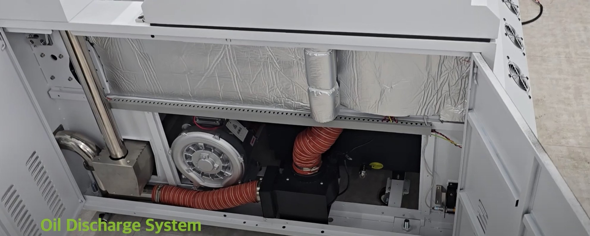

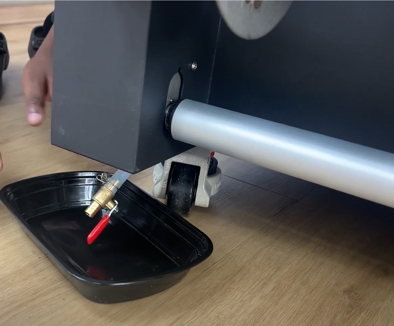

Notice how all other dryers have an oil draining system while this one relies on the filters to soak up all the oil and then you take them out daily to airdry. not safe or something I would feel comfortable telling an employee to be around for 8hrs per day
I don't understand why all of these 36" shaker/dryers are pushing "no exhaust needed". Why not make an optional exhaust available. I'm building an exhaust hook up for the other dryer I'm getting although it seems like it has a way better filtration system + oil collection system than the miro 36
Don't risk your health to a 1" thick filter
victor bogdanov
DTF Station Miro 36 filters that soak up oil, only 1" thick, oil makes it past the filters and is exhausted out of the machine for you to breath in

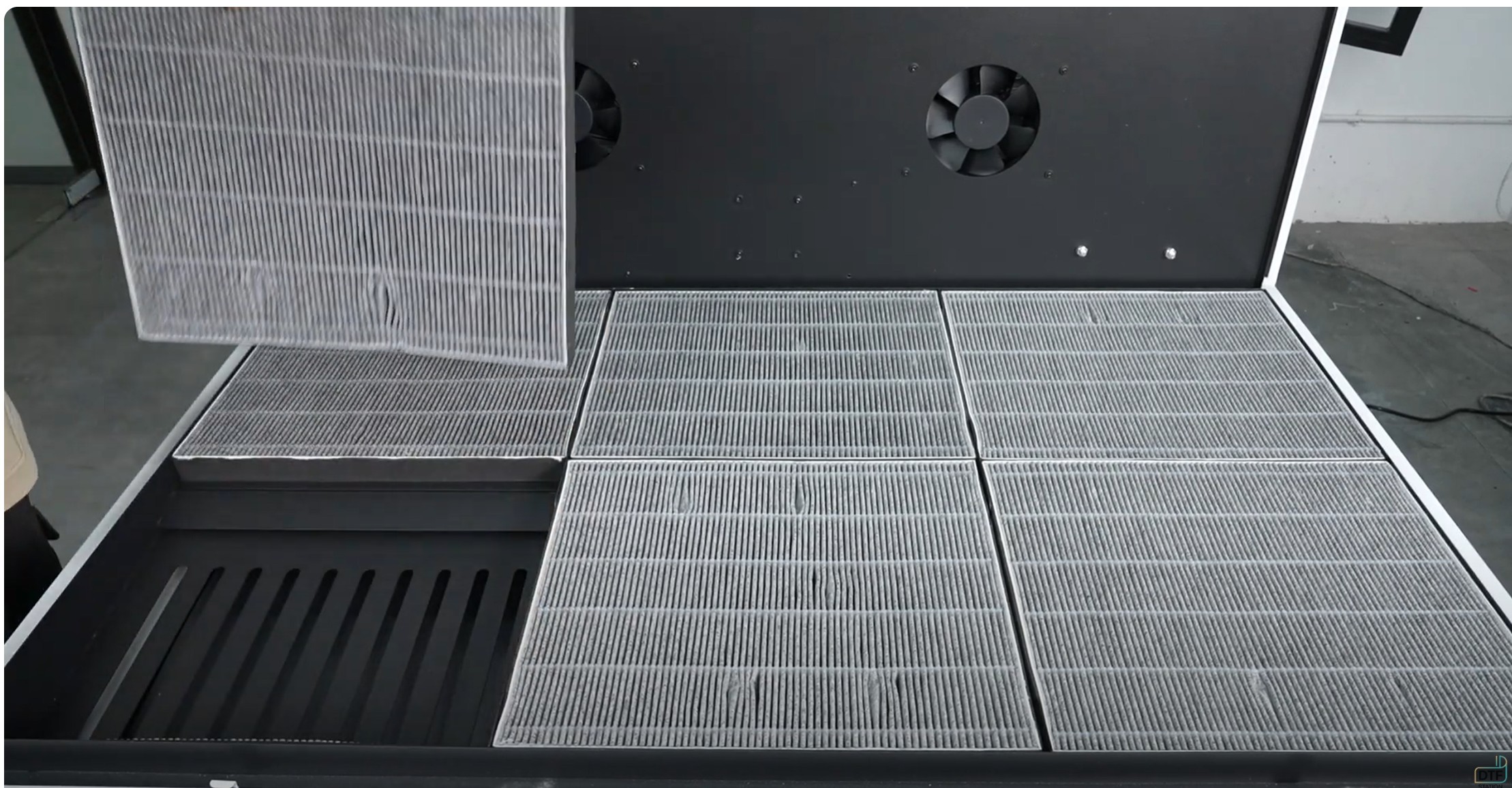

Other 36" shakers: Much thicker filter plus oil collection systems (although I would still create an exhaust, its your health not the sales/marketing guy who says its safe)
