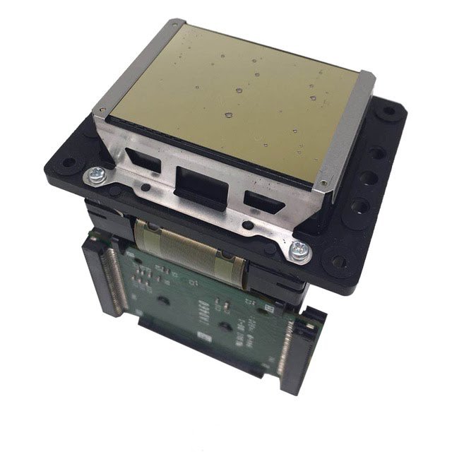

I think Mutoh use same Epson Printhead
Mutoh-ValueJet-VJ-1324-VJ-1624-VJ-1624W-VJ-1924W-Printhead-DG-43988-DG-42987-7402.jpg

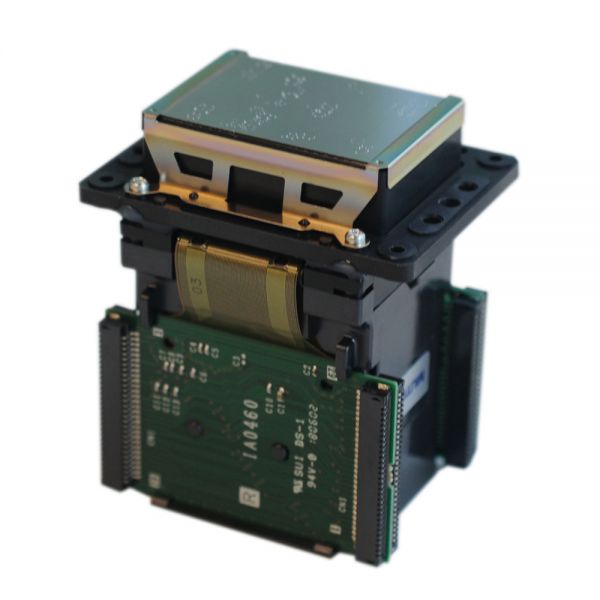

Epson GS6000 Printhead

the head board needs to be programmed for a mutoh, mimaki or roland printer. the gs6000 head is significantly less because roland, mutoh and mimaki upcharge because they source them from epson. You could blow your main board if you just plug it in.

does the mutoh head have 21-digit Head Rank ID (QR code) on the side of the head.this number tell the control the drive voltage applied to the PRINT HEAD is controlled based on the information.if i had to bet the to heads are the same.you will need pc Service Program in order to put the qr code in.here is a copy of the servive manual for the gs6000 https://www.manualslib.com/manual/828293/Epson-Stylus-Pro-Gs6000.html
