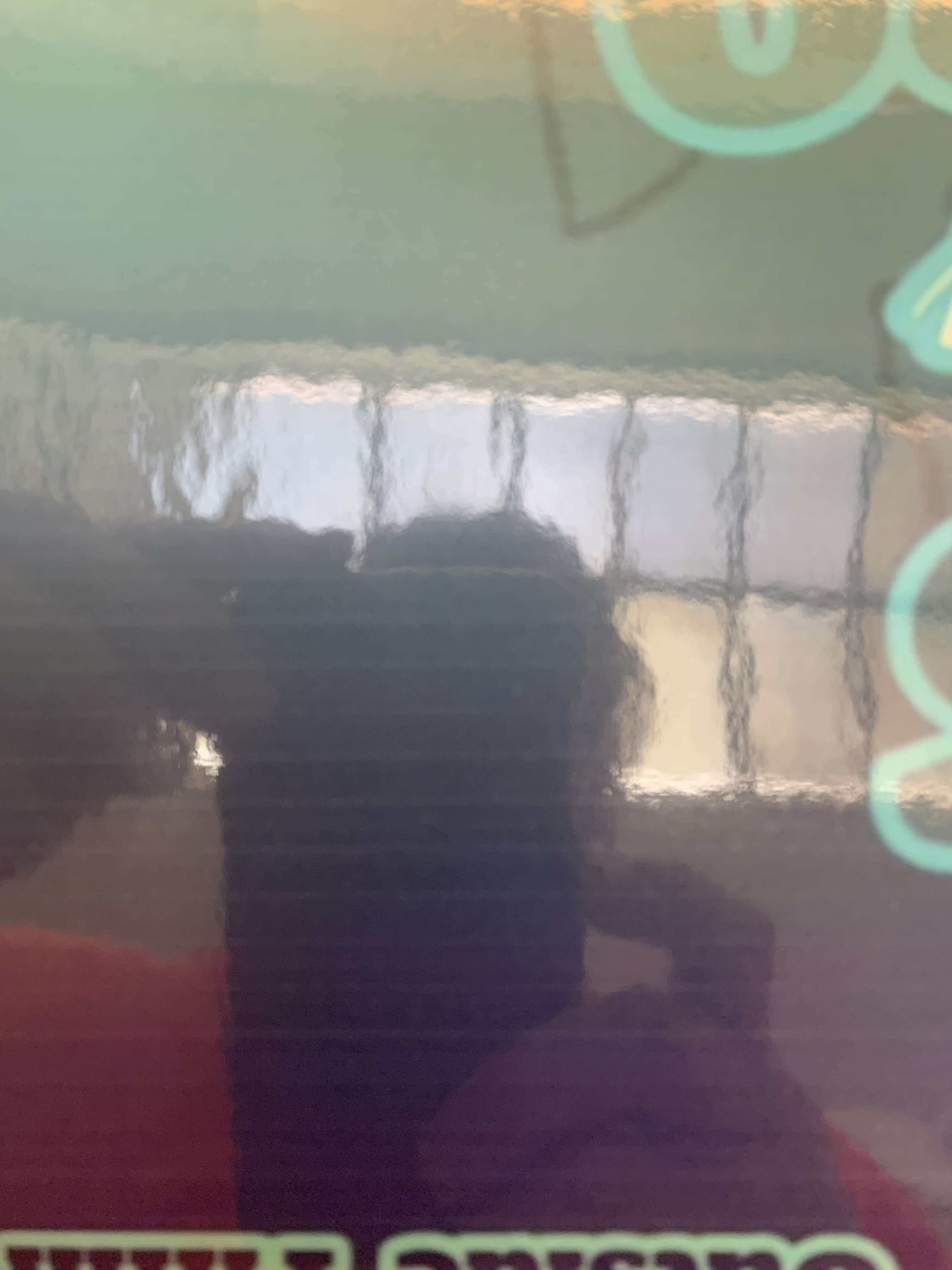

SO we've have our epson for a couple months now with no complaints the thing prints beautiful and quielty and as it should but last couple days i've been getting banding...attached is a picture and not sure why...we've cleaned it very good and even upped the passes to 6 pass high quality and still getting banding
any ideas could it be the profile maybe even? haven't had this issue though before and the nozzle test was flawless
Any help quickly would be appreciated as we are about to print a wrap and can't obviously have this

Have you tried a feed calibration? Try the auto version in "Media Adjust".
I would try it with the takeup reel attached, then perform that operation. I'm guessing you won't see that banding again.

Nice document. I think it's the feed rate and nozzles are fine. 6pass should be fine always, if the media adjustments are done correctly. I can get 4pass on some matte vinyls to look perfect as well.
SignMeUpGraphics
Super Active Member
You can print 6 passes when the printhead is new, 8 pass will cover the clogged or deflected nozzles.
Our machine is over 3 years old and we can print 6 pass (4 pass as well) without any banding like this.
But yes, more passes will hide the issue but maybe not the best solution for everyone.
I would run a media calibration on this again as it can drift over time.

The first image looks like feed calibration.
You say " up to 6 pass". That's our go to, except for banners.
Have you tried 8pass like ewded suggested to get you by?

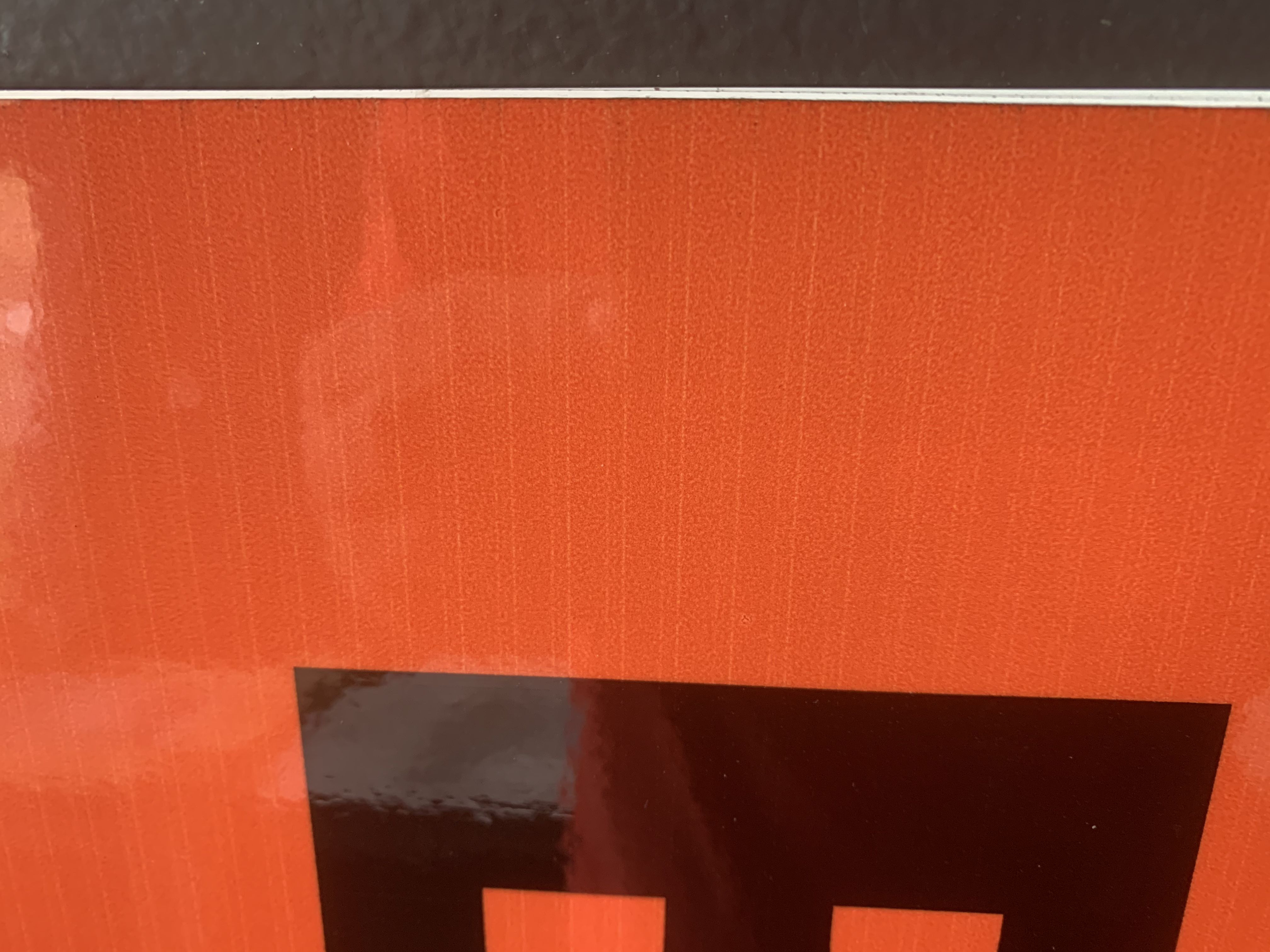

yes on most passes it all does this i just dont understand its like a color drop out across the board no single color more then others just notice it more on greens blues and such because the darkness of color....its odd i can run in uni direction fine but obviosuly that shouldn't have to be how its ran i mean we do 4 pass banner 6 pass and 8 pass vinyl...idk just thought i wouldnt be getting the banding i am with such a nice machine thats ran so flawless the first couple months

Here is a couple more pics
Just not sure it’ll run great In uni but bi is hit or mis I’ll print the same file one perfect one not and it’s just random am completely at a loss and worried I’m gonna mess up a huge print or aomething

Could be some nozzles aren't firing. Sorry I don't have a better answer for you. The orange print does look like you are losing nozzles.
It's true that you'll sometimes have a perfect nozzle test and then a nozzle can drop out when printing.
Not really related to the problem you're having with banding, but the printing looks real blotchy/grainy on that material, I would say improper profile with too much ink.
