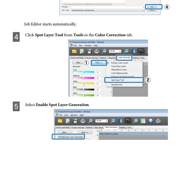

Hameed

I think this could be it...I thought the default name is Spot01 not Spot1. Can you confirm?
Another thing in the manual it says Spot1 is for White and Spot2 is for silver....Is this correct?
My setup is 10 colors and I only have a silver tank installed and no white, so to use I should name the channel as Spot1 or Spot2?
Sorry for all the questions but the ink tank is almost empty and I still did not manage to print Silver correctly!
