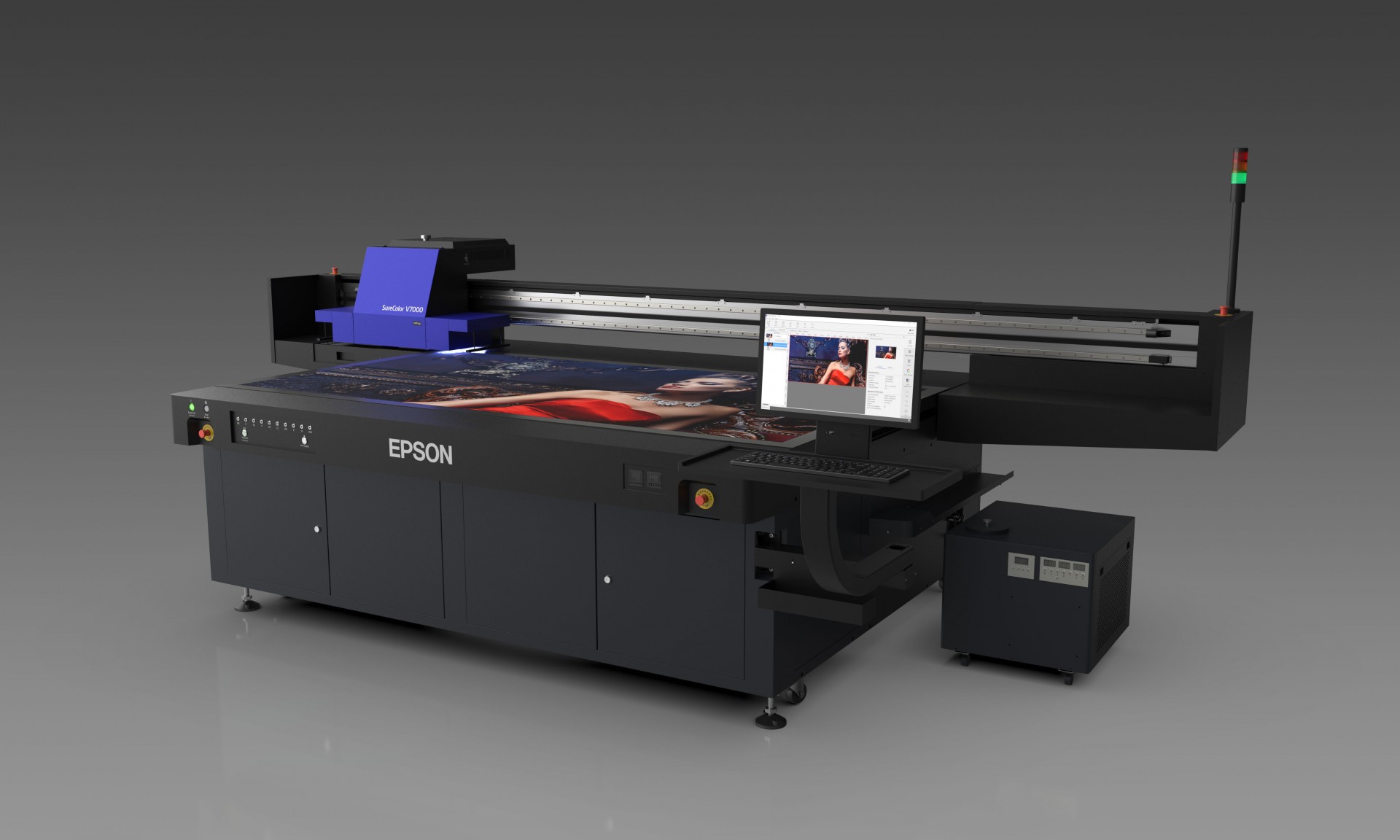

Some more details that are not in this video
- soft UV ink (in other words flexible)
- no loss in speed when printing white+color, color+varnish or white+color+varnish
- target quality segment from low to high (signboard to fine art)
- speed up to 43,1 m2/h (464 sqft/h)
- max resolution is 720x1440 dpi
- 8 newly designed print heads in total, 4 pl is the smallest droplet
- quality on par with the SC-S80600, or even higher at more or less the same speeds
- the ionizer is a standard feature
- no display on the printer, machine settings are done on a controller application
An impressive feature set if you ask me, but price hasn't been finalised. I've been told it will be comparable to the competition (entry level flatbed at this size). Should be at the dealers at the beginning of next year.
