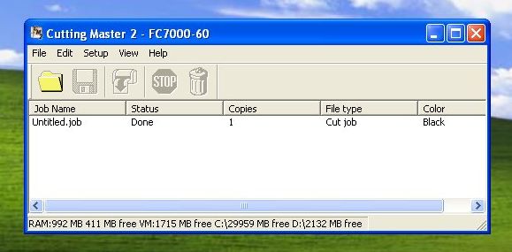

I use the FC7000 and Corel. I must open this application before I open corel and that works for me. It looks like this.
Hope this helps.

Yeah, your are missing the Cut/Plot window.
Try reinstalling into the following directory:
C:\Program Files\Corel\CorelDRAW Graphics Suite X4\Plugins\
