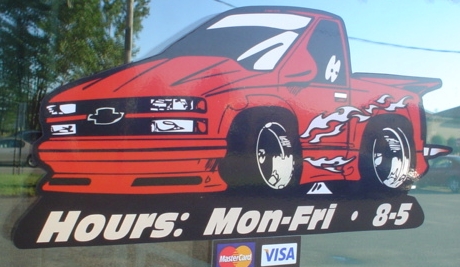

Gene@mpls
Sorry about the crappy pict but this has been on our frt door facing
south since Dec 2004 and is still as new. Gerber silver metal with a
1mil laminate from Graphic Marking Systems. The lettering, headlamps,
door handles and wheels are chrome.

Pat, they look good. Is that the Gerber brand medal? and no primer just straight to black? Thanks again.
