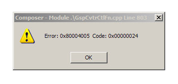

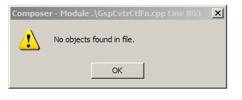

The first image is a screenshot as the file was, in X6, before export, then cut and paste, the export and import as cmx, then export and import as pdf.
Cut and paste did best but added hundreds of nodes. The others gave error messages or no results.

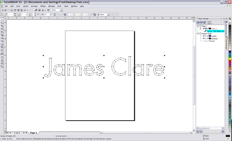

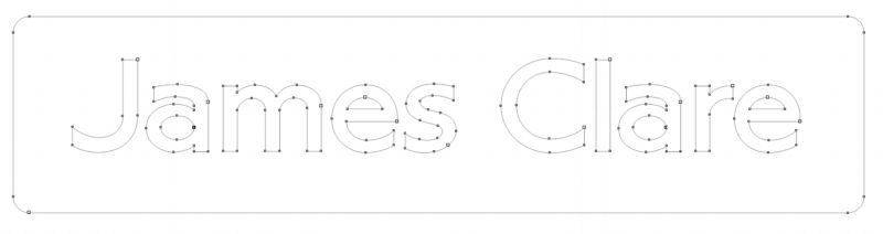

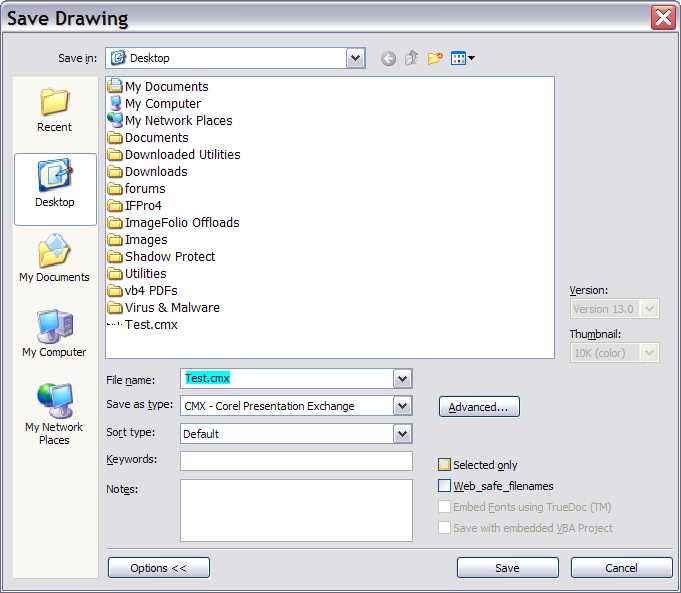

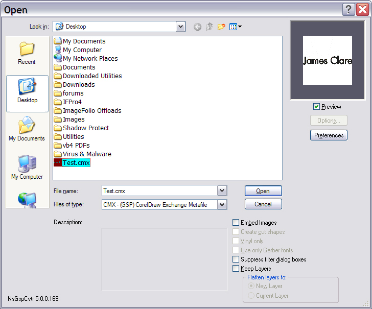

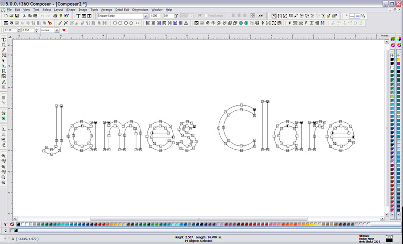

Here are screen shots of text (converted to curves) in Corel and then Saved As Corel Presentation Exchange from CorelDRAW X3. The third and fourth screen shots are the CMX file opened in Omega 5 and nodes turned on. What I see is an uncorrupted, true to the original file in Omega.

Thanks a million for that Fred.

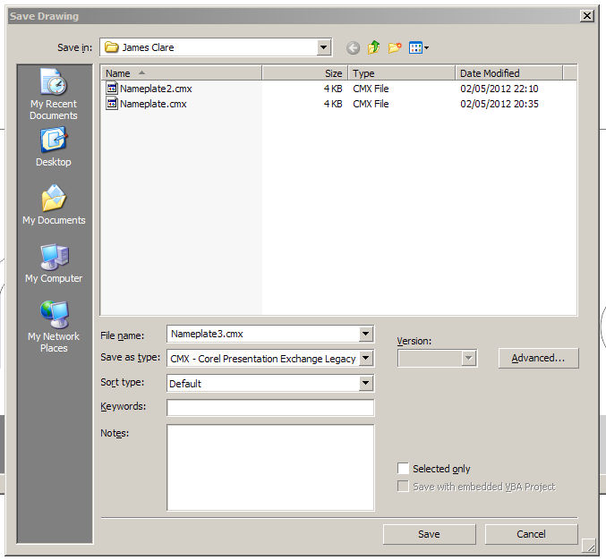

With the help of your shots we are there. In X6, it seems you need to Save file with the "CMX - Corel Presentation Exchange Legacy" filter. Other that it all worked exactly as your step-by-step.

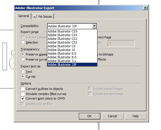

buckssigns
Yes! That works too, Wayne.
Spotted a Compatability drop-down menu I hadn't noticed before and chose Adobe Illustrator 3JP.
I'm really spoilt for choice now.
Thanks again everyone.
