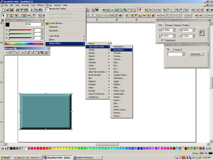

Some filters will work in Flexi, others that require a transparent layer will not.
