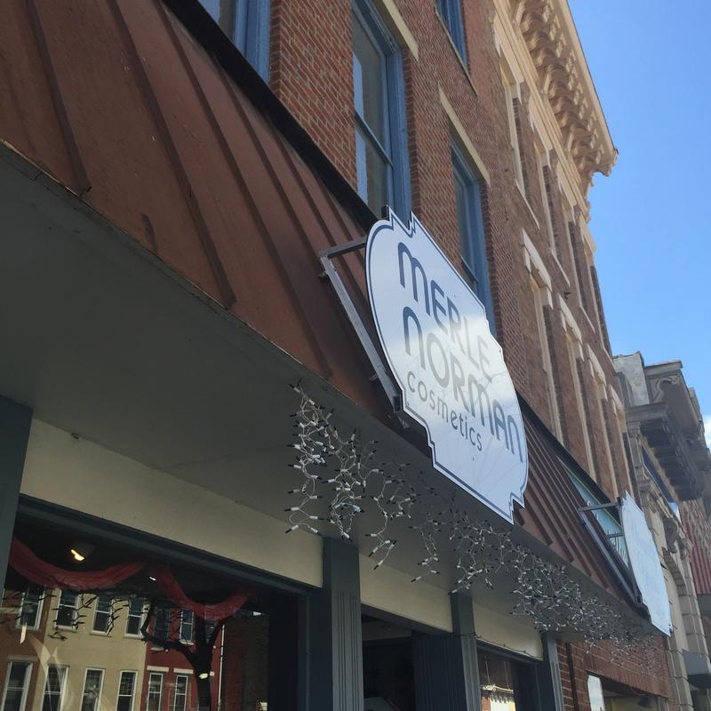

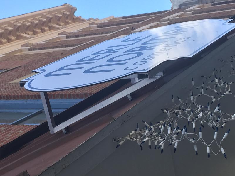

My guess is I may have to use a local shop, anyone here do anything like this? Need the frame part

That is a really nice fab job. We have made these roof brackets with slotted angle bolted at the corners. Mount the slotted angle on the roof (put a piece of rubber roof membrane down first and seal the penetrations well.). Then you adjust the other two pieces to level and the thru bolt the sign. Paint the angle prior to install to match the roof.

My tech could weld that and make it for you, however it's quite a long way away.
