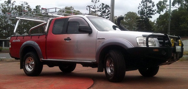

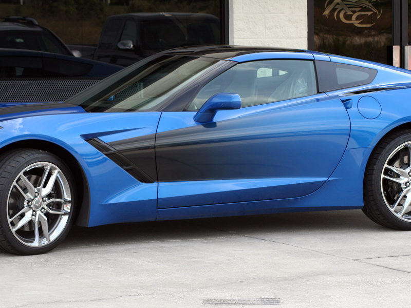

Is it possible the blue and red cars have printed optically clear on them? If ao the color of the vehicle wouldnt have to be printed Damn nice fade are those painted I wonder
altereddezignz
No they are actually wrapped. What would you need to print on clear vinyl? We have a valuejet 1324 haven't printed anything yet we are almost finished with the building i am just trying to learn ahead of time.
visual800
if you printed on clear, in this situation, you would only print the black shading. That way when applied to vehicle it would appear to fade into the stock color
when you say these cars are wrapped you mean just the fade is wrap right?

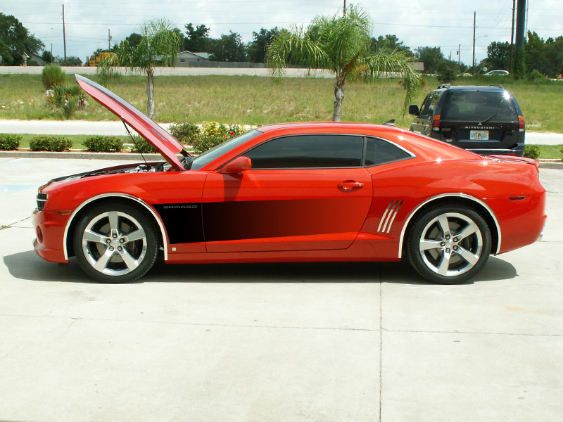

It appears to be printed on clear (as stated above) or printed and then laminated (here's the description):
Give your vehicle a custom airbrushed paint job at a fraction of the cost with our new Camaro Side Graphic Sport Fade graphic! The graphic has been digitally printed and laminated on clear print media with a black gradient. Using the finest vehicle wrap technologies this graphic will use your vehicles paint color to provide the background coloring! Simply wash and wax with the rest of your car for years of enjoyment.
It does say 'screen printed', so I doubt the printers will give the same effect. The screen will hafta have a dot reducing screen, where a printer could probably get much finer detail. Heck, its all spelled out for ya...... give it a try.

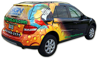

edit: with the last photo that is fading from yellow colors to black, its either printed using white inks, or printed on white and fade to a black print that is easy to match with factory black

thats why I said that the flowers one was either printed with WHITE ink, or printed on WHITE. or the yellow would be a slightly yellowey black
