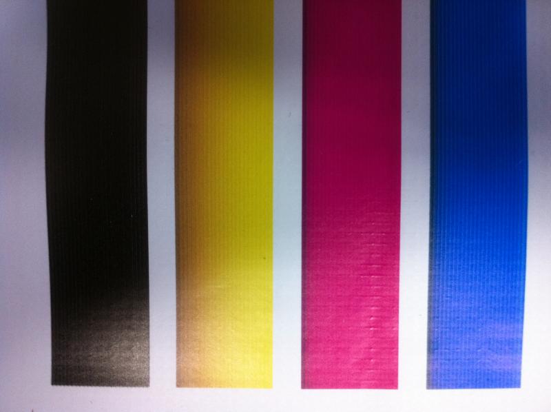

My colors print starting out really dark then fade to the actual color. This started after the pad swelled and caused contamination. I have replaced all the dampers and drawn lots of ink through with a syringe. Do you think there is still some contaminated ink somewhere getting in the head? Where would it be coming from?
Thanks for any help.
Stuart

The caps have screen on them so there is no way the pads are touching the heads. The pad does show the cmy colors. It prints like the photo everytime you print. It can be five minutes or 5 hours it always starts out with the dark color then fades to the correct shade.
The drain lines to the waste tank are free flowing. I have drawn ink through them several times with a syringe to try and pull out any contamination.

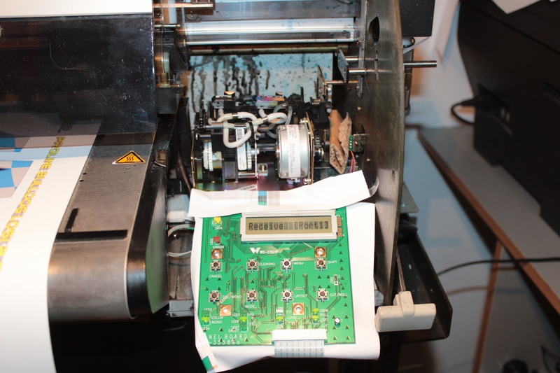

I disassembled the controlpanel so I can see what happens during cleaning.
Set up the video camera to record what is going on for later analyzing.
While the cleaning is busy I notice the wiper stays on its home position. Hum! Not ink at all on the wiper. The complete maintenance unit was replaced 3 weeks ago for a brand new one as was the print head.
When the cleaning is finished I try to move the wiper holder but it is stuck. While whiggling the holder it suddenly says click and it moves forward and backwards. Start the cleaning and whow the wiper is moving during the cleaning cycle. First and next prints are without missing nozzles and no dark start of the printing.
So if this happens again check the wiper on its function.

For those who run into he same prboblem
Got the problem again of the dark start.
Checked the wiper and again the wiper was stuck. :-(
Removed the maintenance station and took out the purge unit with wiper.
The sliderpart where the wiper is attached on should move easily.
In my case it was not so I removed the two screws at the wiper side and carefully took the plastic side frame off. Take care there is a spring behind it!
While moving the sliderpart by hand I felt to much resistance.
As the whole unit was newly bought 2 months ago I could not think something was wrong. I disassembled the slide part furhter and found in between a residu of glue or something like that. I used washing petrol to remove all excessive residyu and chekced by hand force and voila it was sliding and rocking again.
Reassembled the unit and the maintenance station.
Now it cleans OK.
