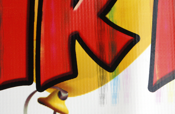

A few inches into a print these lines appear. When the lines start to appear I can hear a bumping noise. As lines get worse so does the noise. I can put my finger on the print head and feel the bump. The printer is printing well except for these lines. The nozzle checks are fine.
I have cleaned all of the rails including the encoder strip on top.I can't see anything that could be hitting it. Could a bearing be bad on the carriage?
Any help would be greatly appreciated

Looks like head strikes on banner material.
Lower your temp settings and raise the head to high head height.

I tried lowering the heat ( off ) and the print head is in the high position. the noise is still
there. The marks are also still there. Something is making the carriage run unevenly. Any ideas?
