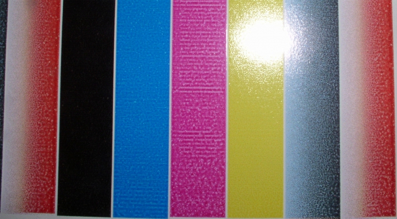

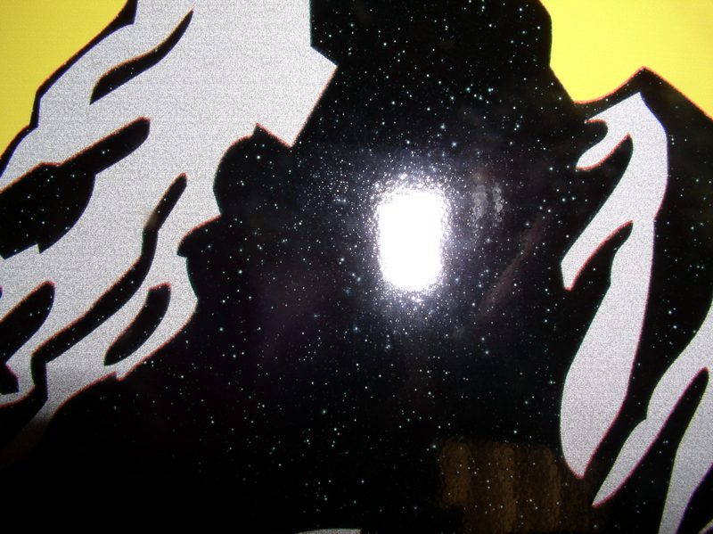

I have a Falcon Outdoor and it seems that the ink is having a reaction as it gets kinda a fish eye effect. What could be causing this? The attached picture is a print on 3651. Any ideas would be great. Added a picture that might show it better in this black area.
Thanks,
Grant

Take a look at your dpi settings and ink limits. If you have the dpi set to 1440 instead of 720 and did not change your ink limits your prints will come out like this.
Jackpine
As said, wipe the material and turn the heaters down to 45 and 45. Lower your ink limits I print with the limits set at 65 and 130 in my RIP. 720x720 bi-directional is generally a be a good resolution.
