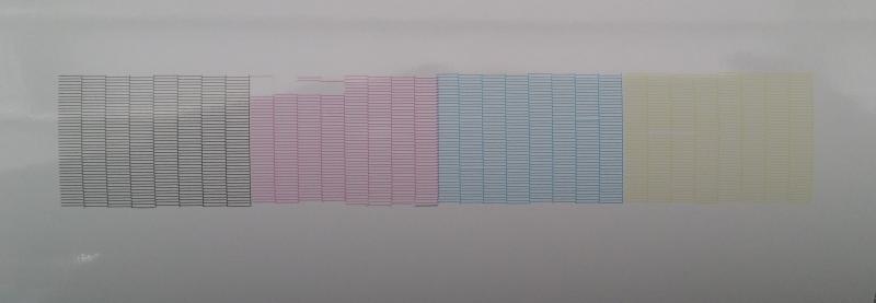

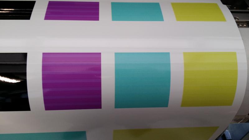

Hi Thanks for the reply, if you notice it was 11:30pm when I wrote that post I was quite frustrated at the time and i'm at witts end with trying to dial in this printer.
I sorry for not being a little more pleasant.
If anyone could help I would be more than appreciative.
Installed:
2 new pumps
4 new caps
8 new dampeners
New black head
New cyan head
yellow looks fine
magenta 90%
attached are the screen shots
P.S. Yes Ive done the searches downloaded the manuals and have done (I Think) every thing besides a mechaical adjustment and the fine tuning in the adjust menu.

was the magenta acting goofy before all of your replacements?
you might just have some gunk on that part of the printhead, and even though you're not supposed to touch the bottom of the printhead... I've been able to take a foam swab that is saturated in cleaning solution and give the bottom of the head one gentle wipe in the direction the wiper usually cleans it. repeat, if necessary, BUT only with a clean swab per swipe. (you can easily lose nozzles if you scrub pigments into the nozzles and clog them up.)
otherwise, it looks like it just may be a loose-seal between the capping station and the magenta head, improperly refreshing the siphon of the ink supply. when this had happened to me in the past, I just gently pull-up on the cap to raise that black rubber captop seal ever-so-slightly, so that there is a snug-fit when the head parks on it.
you also may need some flushing to get the head back to 100%, as the ink has most likely been sitting stale on that part of the head for some time now. a few 99min nozzle washes should do, but if it's still not helping then you may need cleaning cartridges and a headwash.

MikePro
pumps, caps, head replacements and you don't know how to run maintenance on the machine?
no wonder you have issues :)
no biggie. Function menu > Maintenance > Nozzle Wash
fill the caps with cleaning solution, press enter when prompted.
p.s. I ran Disway Wash twice a week, Nozzle Wash at least once a week, and was constantly cleaning my wiper/capping station for 6 years and never an issue until my heads just plain died from overuse. Maintenance schedule is key, or that ink will build-up and ruin your machine.
