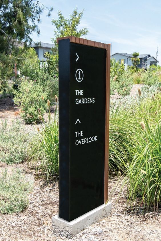

My customer is looking for wood elements for their signs at a fancy golf course. However they want it low maintenance. Thoughts on faux wood options for exterior that you have had any lucky at? I find just printing looks cheap and fake but maybe some siding construction type materials?? Wood stain can be so high maintenance and we're in Canada with winters and hot summers. I've attached a sample of what they're after.

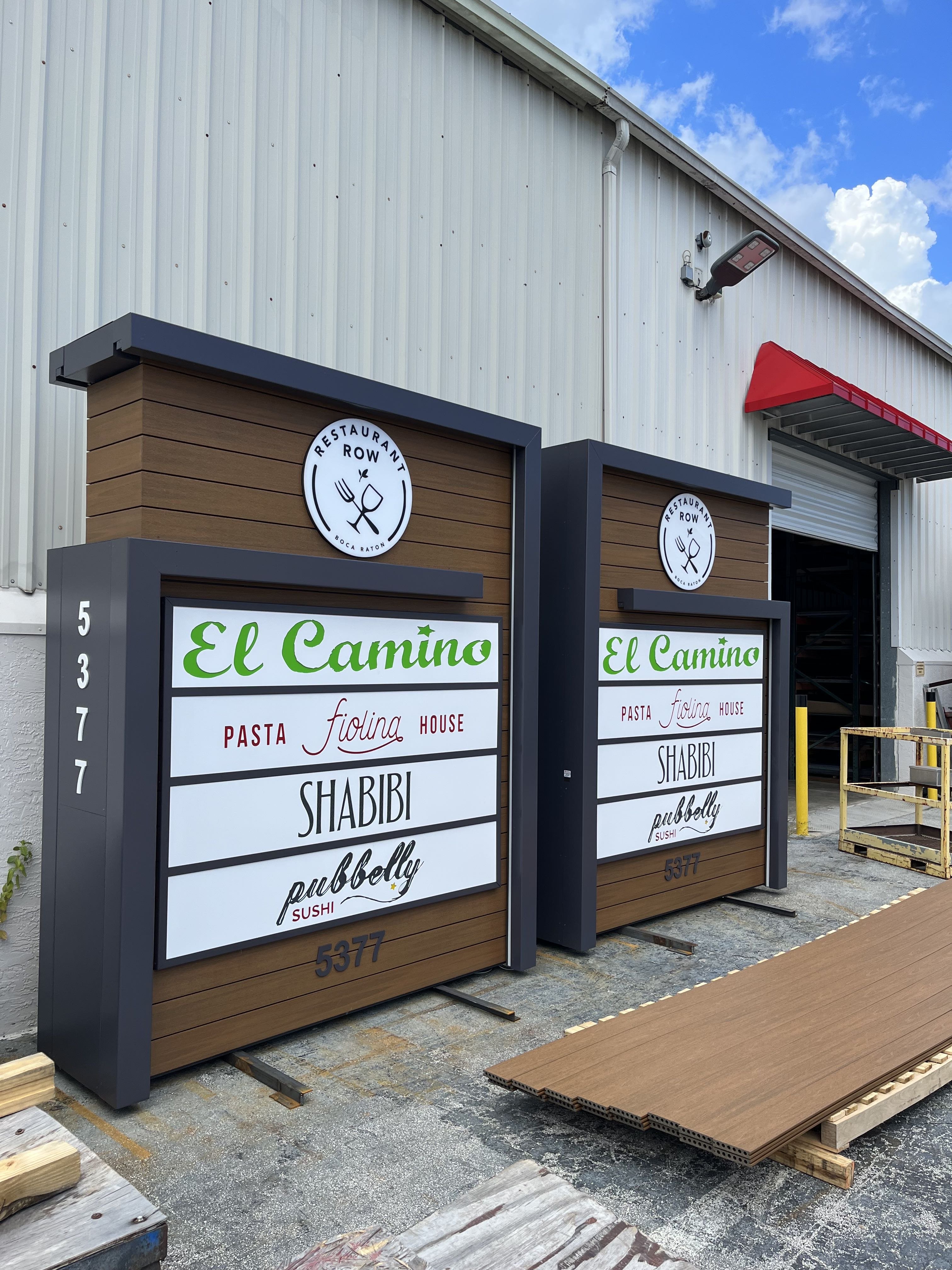

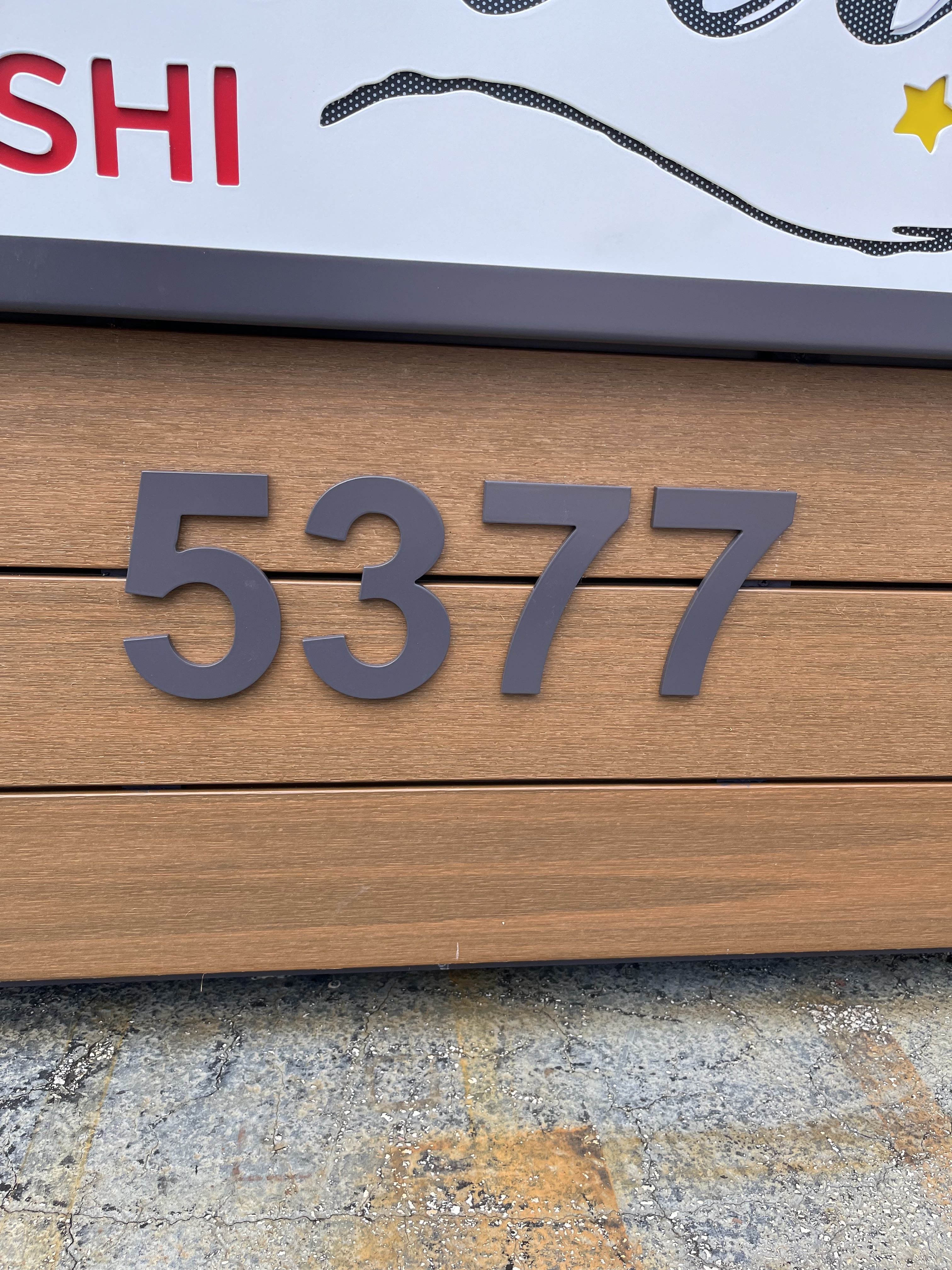

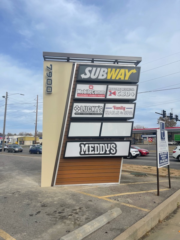

We just finished a ground sign using Nichiha panels. I don't have any pictures yet, as it is in South Dakota being installed in the next couple of days. We called the company, they sent us to a local supplier, which I remembered we used the local supplier the last time. Which is the sign in the picture I have here.

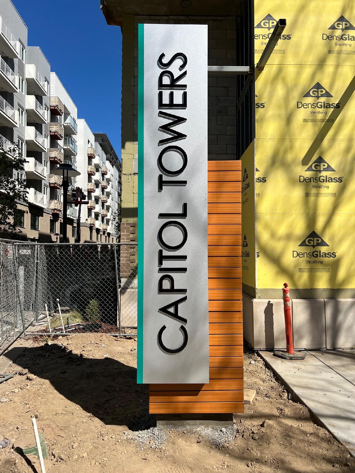

Look up Alura Woodgrain Architectural Products. Its metal siding with a fancy Kynar coating.
