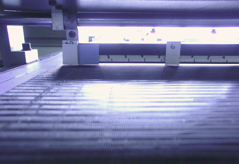

I just bought an FB500. We didn't get the roll option. We tried running a 60 inch sheet of 15" vinyl through and had tracking issues. I guess I'll need to buy an aftermarket take up reel . The detail of the prints is great but so far I'm disappointed that the regisration bar does not come all the way down to touch the belt, there fore you can get thick materials into place much easier than thin matertials. 30 mil and less slide right under the registration bar, making it a mute feature. The experts say to bend the sides of the sheet a bit so that it touches the bar and then let the sheet flop onto the table. Sorry but I'm a perfectionist ,especially when I'm trying to print on top of a kiss cut.

different printer but this is what i did. added pieces of pvc with vhb so that the tabs would barely brush the belt. i print on a lot of .030 aluminum and it was too thin to hit the bar.
