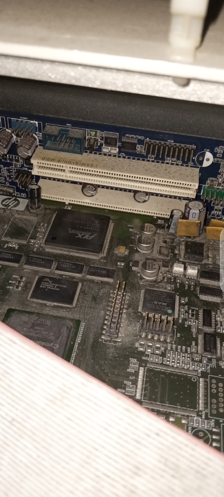

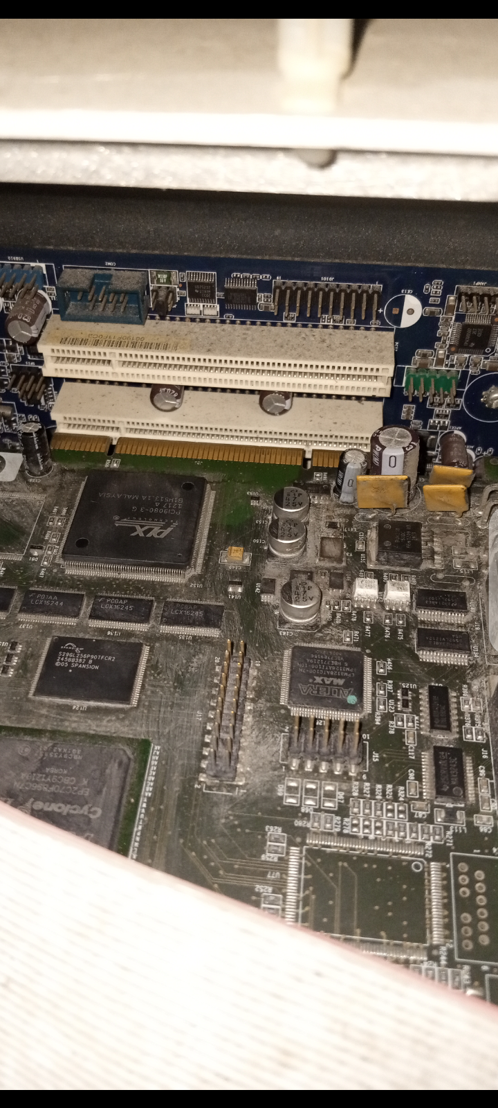

I'm having a big problem with my FB700 printer , after shutting down the next day didn't boot up stuck on blue HP logo without any initializing info at the bottom of the screen.
I opened the user side the fans on the ebox not working when i turn on the machine , only the CPU fan on the mother board working, after several test , no hope , so I unplugged the io board from the PCI slot on the mother board and i turn on the machine , the fans works fine but still didn't boot.
Any suggestions please I'm afraid that the io board has a problem , its very expensive

netsol
You could see if inkjetperformance.com has any experience with these
They have been my go to for a while, (we stopped repairing our own boards)
Have you had a look at a service manual?

There is nothing in the service manual regarding this problem , I also brows all over the internet and forums nobody had this problem before , I'm preying now not to be the IO board .

I have no experience with hp flatbeds, but, a likely guess would be that the hard drive is failed or failing

I would suspect hard drive first, long before i blame io board

But why the fans in the ebox didn't work if I plug the io board and work normal if I remove it,
netsol
My guess would be the command that starts the fans is not being initiated
There is probably a small program monitoring temperature, a couple thermistors that sense a heat sink temperature or simply ambient air temp to vary fan speed
Also could simply be a switched power supply voltage not turning on because of an abnormal load or just a power supply going bad
