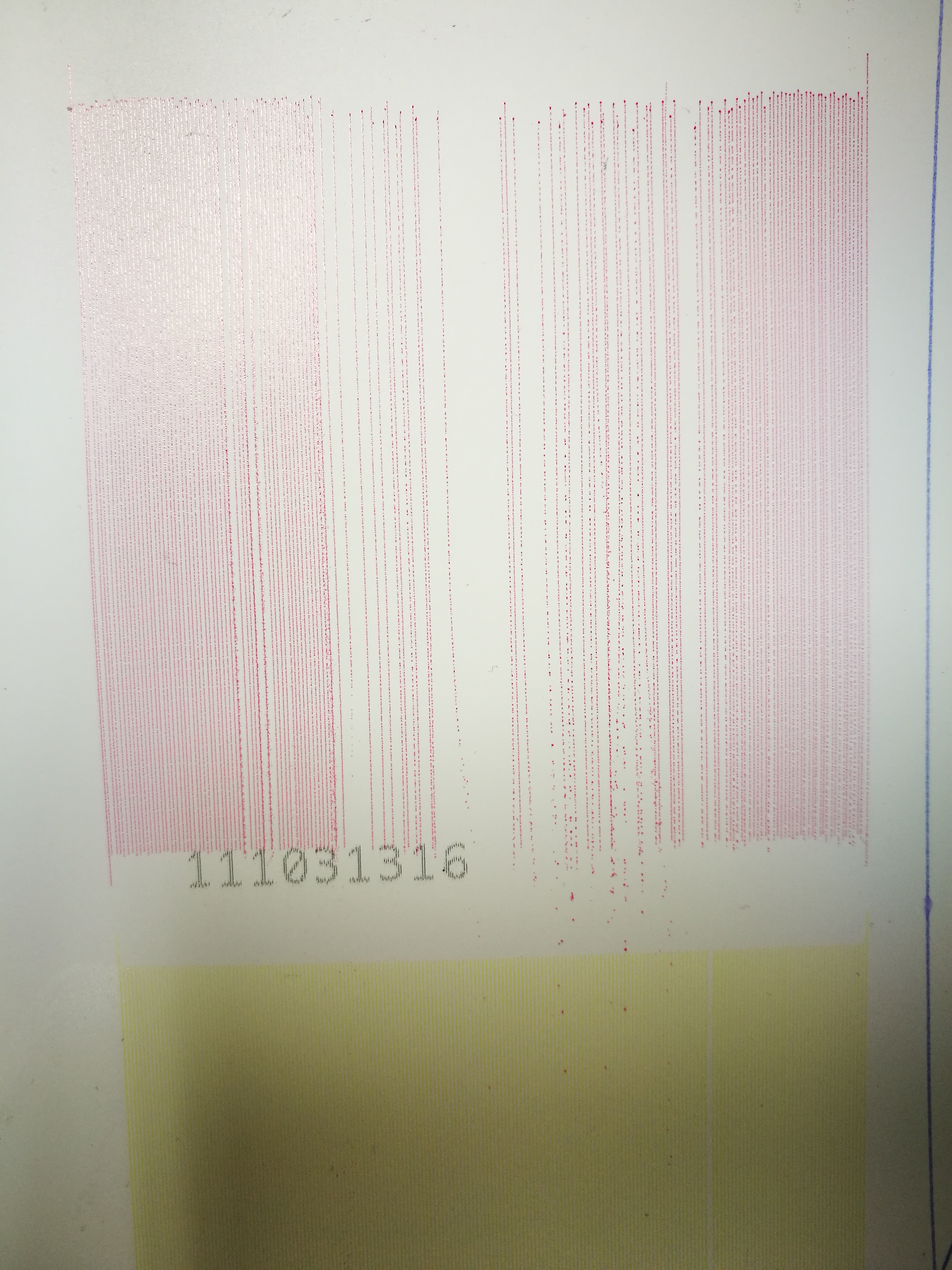

Now we have problems again, black and magenta heads overspraying and printing really badly. But it's not the heads this time, we have swapped position of the heads and the problem remains in the same head position (mostly on no. 2 and 6, but 1 doesn't look that great either. Nozzle test (prime bar) looks great. Other tests very unsatisfying. Any ideas?

I agree with you on the difficulty with diagnosing, seems as if many different hardware issues result in the same problem, and after our latest long tussle with HP we try to do things ourselves (but I prefer whisky). I've been maintaining our Roland solvent printers earlier and mostly find the HP easier and not as messy - if you only know what needs to be done.
Now we have problems again, black and magenta heads overspraying and printing really badly. But it's not the heads this time, we have swapped the heads and the problem remains in the same head position (mostly on no. 2 and 6, but 1 doesn't look that great either. Nozzle test (prime bar) looks great. Other tests very unsatisfying. Any ideas?

Man that's a tough one! My first guess would be a bad head but if the problem doesn't move with the head then that's not it. My next guess would be media thickness sensor giving a bad reading and it's raising the head height more than it should, resulting in overspray. If it's a head height issue you would see it across all heads, but if you're material is buckling/warping during printing it could give you the result you are getting and only express itself seeming on certain heads. Be sure your material is perfectly flat and not buckling. Overspray generally relates to head height off media. Another long shot would be the voltage to the problem heads...which is a setting in the service menu which is hidden (I can help you access it if you're not familiar). But since you had an HP tech working on things it's possible that tech changed the voltage on those specific heads in order to get those heads working correctly, which could have been a mistake the tech made while trying to diagnose your previous problem. The setting I'm talking about allows you to add/subtract voltage to specific heads, so as a head gets old and isn't jetting as strongly as it used it then you can add a little voltage and get a little more life out of the head. But if your previous tech added a bunch of voltage to those heads and didn't change it back then those heads could be spraying too strongly and giving you overspray. I'm running some prints on my FB550 right now or I'd give you the menu locations (can't remember off the top of my head) and the code to access the service menu....the code is as follows: up up up up, up down up down, up up down down, up up up down
signman315
Signmaker
Another thought could be air in the ink lines...fill the problem heads with air 3 times, and the fill them with ink 3 times (these can be done via maintenance/purge menu). And see if that helps.
signman315
Signmaker
go to tools/service printer/device tests/pod test....and type in the up/down code I gave you and that will access the service menu. Don't change things here unless you know what you're doing....once you've typed in that code go to tools/service printer/set head voltage adjustments....from there you can see if there have been any adjustments made. It will list each color with info for each. They should all match...for example all of mine are set to "Low 14.90V, Percent 110, offset 0.00V, High 28.00V" if you want to increase/decrease then change the percent accordingly only making small adjustments like 5% or so to see if there's any difference. But even if you don't change anything at least you can see if they are all the same and if the HP tech messed with it at all. When you are done restart the printer to close access to the hidden service menu. Hope it helps!
FulSnygg
Thanks! We already access the service menu and we have the manual as well. Will try the purge-thing! You help is much appreciated. Have no idea if they changed the voltage, the problem last time didn't affect the magenta and black heads.
We did the height sensor-test in the service menu and that came out fine. Height sensor have also been cleaned. We have tried different materials to rule out problems with static and wrinkling etc but it’s all the same.

If it was just magenta I'd say it's your ink. On these forums, and the tech we use has told us hp has been replacing magenta Ink left and right due to bad batches.
We had the same thing... Prime bars looked the same, only magenta was misting and having issues. We bought new ink... Purged the lines 3/4 times and it fixed.... Turns out the ink was bad.
Do you shake your ink? It could be that your lines are filled with unshaked / unmixed pigment and it's causing the mist.... I'd shake all your boxes... Empty and fill 2-3 times on both blacks/cans and see if that fixes the issue.
There's a test that will print a color bar for each head you select. One helpful thing for me was printing cmyk head one for the test... And cmyk head 2 for the next test. If both heads are misting for the same color you know it's likely an ink issue as both heads failing at the same time is rare.
I forget the exact steps to get to it... But I'll take a look tomorrow when I'm at work if you can't figure it out.

Today we got confirmation from our HP service partner that HP are having problems with not only magenta ink, but also black. We are ordering new cartridges to see if that might do the trick.
