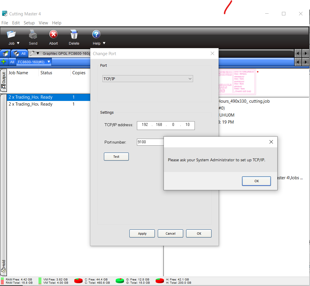

THE BIG PROB atm i got is i tried to connect it by IP , did enter the Ip 192.168.0.1 ( this is from the plotter screen ) but seems its not connected to cutting master 4 ( it says contact to your system administrator to set up TCP/ip )
also every time i send the job to cutting master 4 , it's still saying not responding ( freezing window )

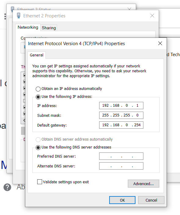

Look what your computer has and addition 10 to the end. Put that in the cutter. Try again.
thanks for your help , did you mean this attached , i did change all the details same as the plotter but its still saying try to contact system administrator ?

i tried to change the plotter ip to 10 at the end and also for computer settings but still not working. do you reckon anything ?

download advaned ip,scanner & scan your network, it will show all visible devices in your range
it will show manufacturer (not plotter but the network card itself)
the ip address is 12 digits ie: 192.168.001.142
first 9 have to be the same or will not be visible
