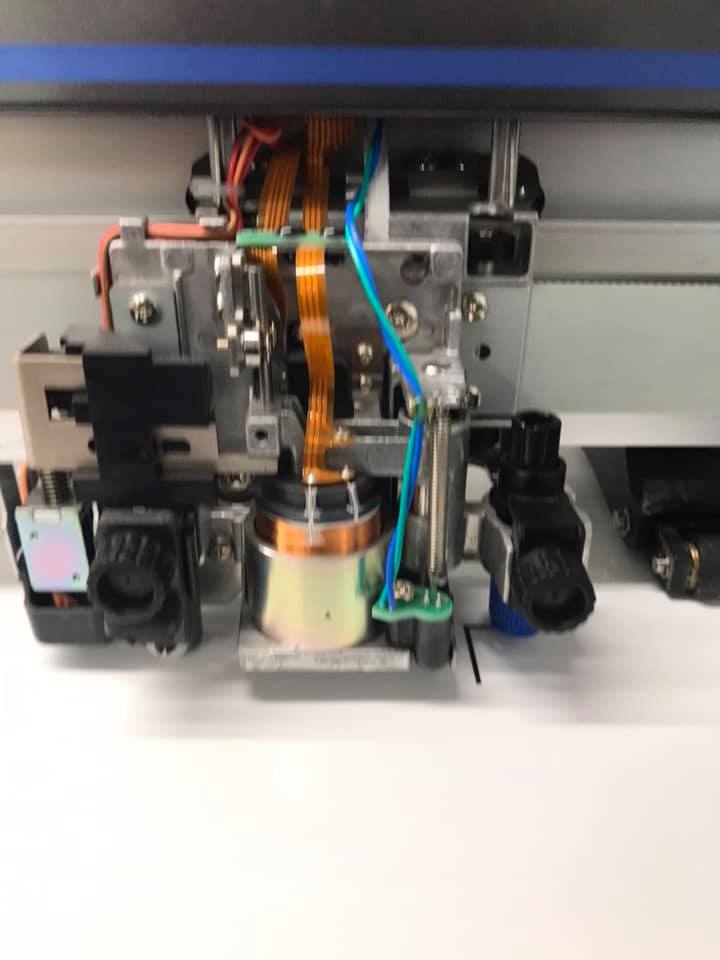

I have a FC8600 64". It's about 6 years old. After a pretty large perf cut job our cutter is acting up. It's dragging the knife across when setting up. Also not cutting all the way through any longer. Replaced the cutting strip. No difference. I pulled the cover off the head and found a spring back there which seems to support both the cross cut knife and the cutting knife. Does this need replacing? What else would cause this issue?

You could have worn out/"burned" the main actuator right there in the middle. Anyways it's pretty standard stuff on older cutters to be replaced if they have been worked hard.

Your sheet cut blade didn't disengage. Simply press the plate on the left side and lighly lift the blade holder to disengage it. If this happens again, you probably need to calibrate the sheet cut engage/disengage position.

thank you! I heard from Graphtec and they also suggested the calibrations which I did and it's working fine now!
