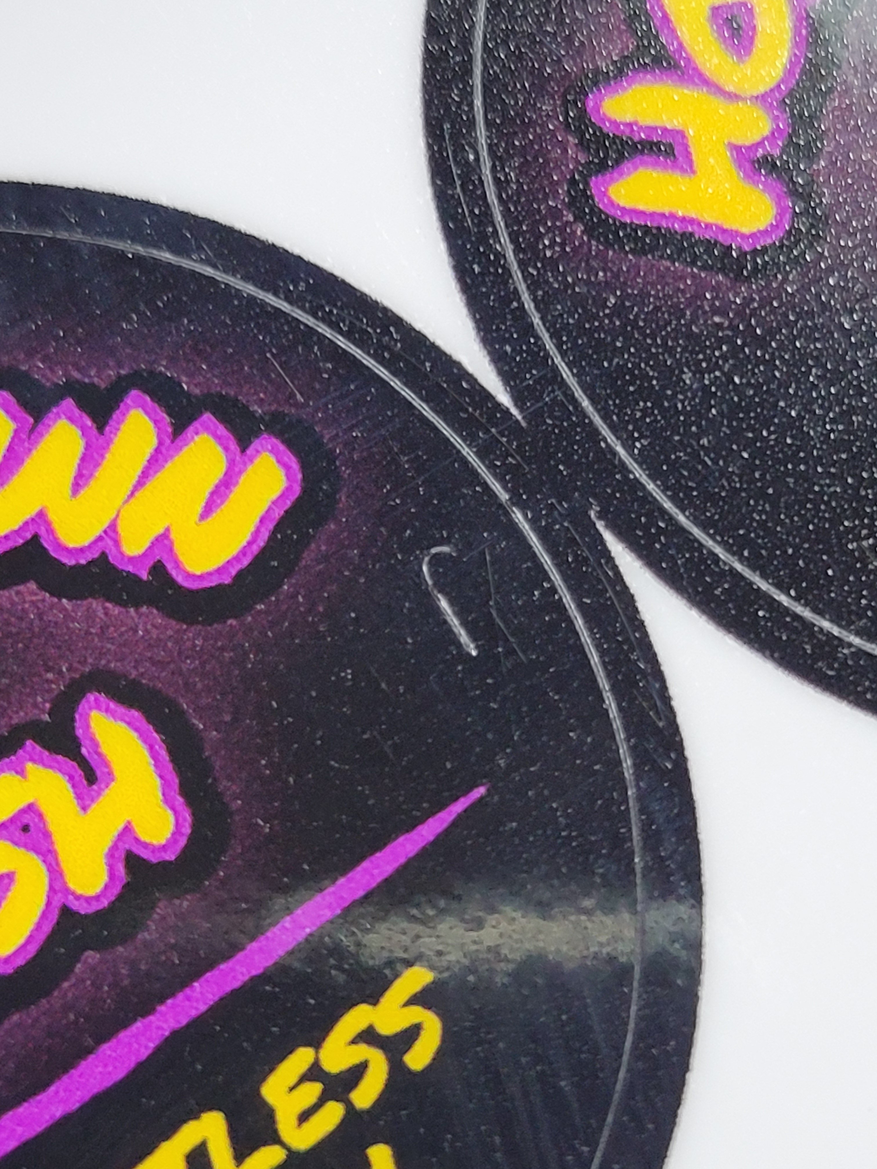

Also I've got this odd hook mark it makes before it starts cuts. It does it on test cuts sometimes. I can barely see the blade sticking out of the holder so I can't imagine it's that. It's doing in work as well, in a spot that it's not even supposed to cut.
