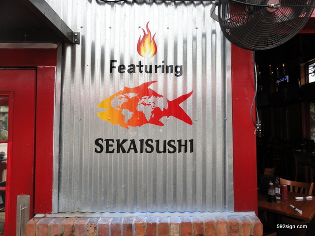

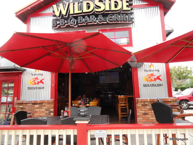

Craig Sjoquist
This corrugated job was one the rediscover another way to do the job and was well suited for it.
With unsoiled corrugation and fairly smooth with the blend, only choice was stencil and xacto.
The layout was drawn by hand, electro ponce, removable vinyl applied, hand cut, blended & painted.
Measured corrugation with masking tape to get correct length.
