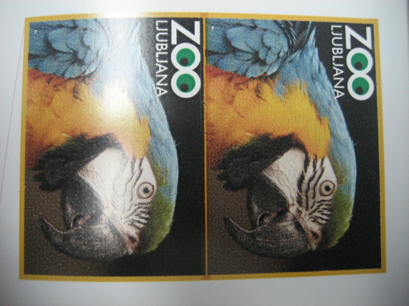

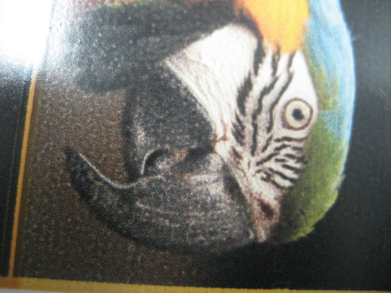

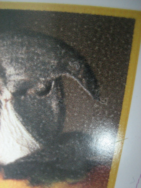

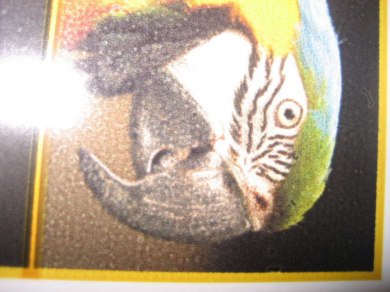

Today my day started very badly! First, i printed some things, and i noticed that gray (should be 50% black) has too much reds and i guess not enough yellow. But i leave it to print 'till end. Then later there was some red text on print, and it was almost magenta red. Ok, must be some problem with yellow. After it printed everything i did nozlle check and all colours are shown, so, there was no problem with delivering yellow color into print head.
Things that may couse that:
- i have yellow and black unoriginal, other colours are still original - i'm waiting to empty them.
- i was putting head in low position, but than i put it back on high...
Than i thought unoriginal colour isn't so strong as original, so i replaced yellow and black with original. Than do a lot of printing, so that finally original colours came through. But i noticed, that printer is spitting much too much color. I don't know the exprecion for what im try to say. Colours doesn't dry nice, they are spilled, or something like that... I the morning it didn't print so much colour! Could be profiles the problem?

Profiles determine how much each and what proportions are printed.
This however, looks like bad media, or wrong media with the splotchy appearance.
