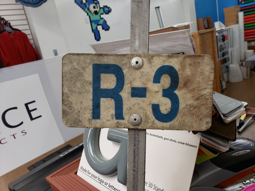

I've got a lead on some fiberglass signs that may pan out from a company called Accuform but I'm looking for any other leads that are available, if possible.

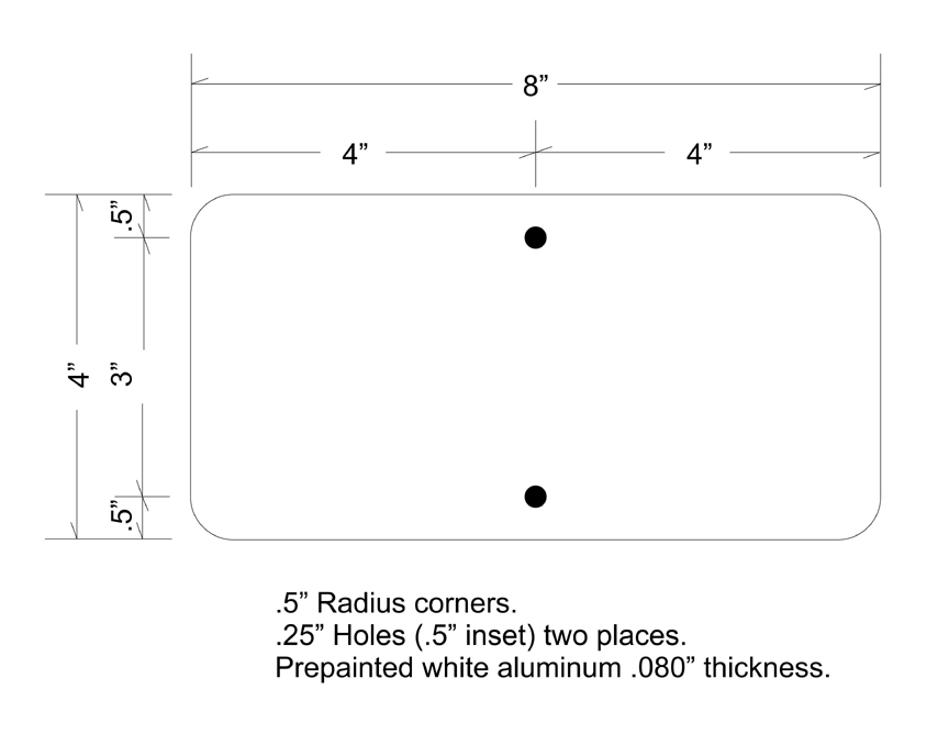

A customer is requesting some 8" x 4" fiberglass signs, approximately 150 of them, each with a different letter/number on it. These would have a .5" radius, two 1/4" holes and would need to be approximately .060"-.080" thick. We've never really dealt much with fiberglass signs, so this is new to me. I'd really appreciate any suggestions as to vendors who can produce something like these. Thanks in advance.

You can cut the size you need and stack them with a couple pieces of double sided banner hem tape and cut close with jig saw and then use belt sander to make the rounded corners. The stuff cuts easily.
