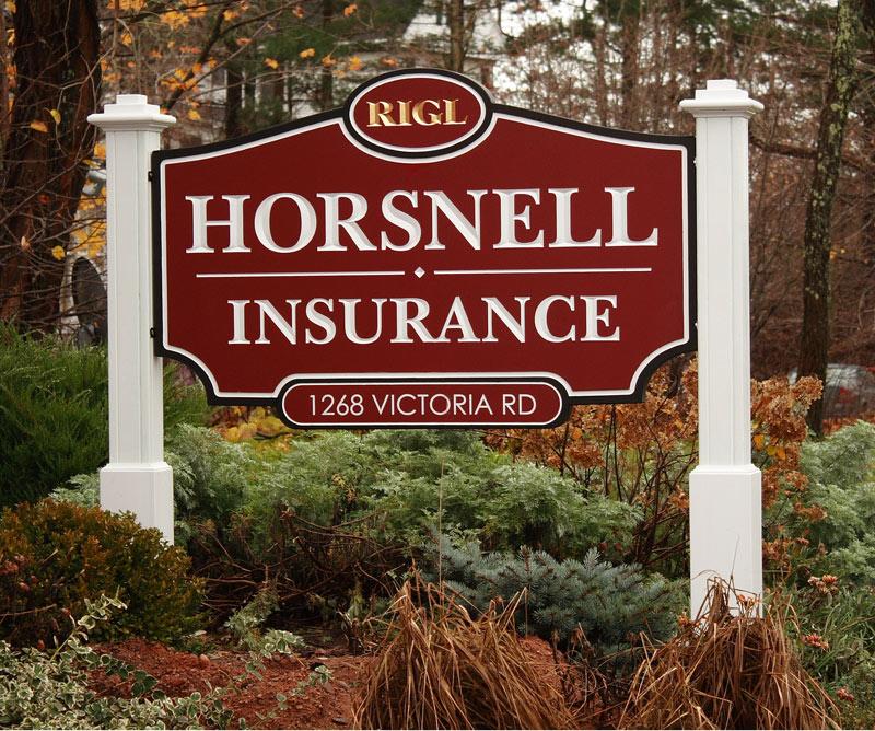

What a load of crap! I roll my signs with latex house paint and they look great.... close up too. If I wanted a handcrafted sign to look like the side of a fridge I suppose I'd have to start spraying them. (And I do have profesional spray gear and I do know how to paint a car)
Here's a sample:

From a PM from Keith: "This image is exactly what we're going after. Would you mind telling me the steps you did to do this? (you mentioned painting them by hand....are you meaning with no mask?
I'm just about to try the BenMoore Aura line before I leave today....I have very high hopes that this will dramatically improve things.
Thanks!
-Keith"
Keith I do pretty much what I posted in post #36. I paint the panel with a foam roller(gasp!), apply the plotter cut mask, carve the letters by hand, seal the cut letters/mask with the background colour and then paint the letters with a brush. (Of course, all my signs look like total crap because I don't use high end spray equipement like andy and UFB.)
