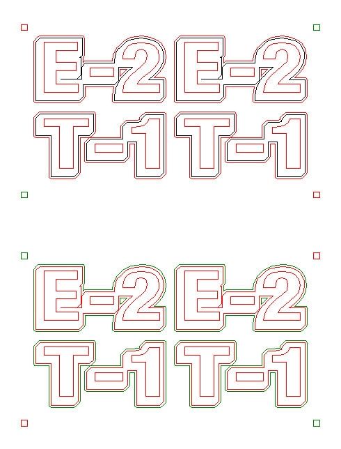

I've always done these on a Gerber Edge, so my process may differ but I've done literally hundreds.
The Edge prints the black directly onto the gold leaf (or whatever) eliminating the need for layering/registering vinyls.
You set up your artwork with two cut lines in it; one for the edge of the gold and one for the edge of the clear.
Then you take your artwork with two lines and make two separate pieces that are EXACTLY the same total size (for registration); I put little boxes in the corners.
Then you print your black onto the gold.
Next you put the vinyl into your plotter and cut the gold, and weed it out, but do NOT remove the registration mark(s).
After that you laminate the whole piece.
Now you load your piece back into the plotter and get the registration marks set up, and send the 2nd file that has the offset outline to just cut the clear laminate.
This also works well for wide-format printers.
I've done some high-end partial wraps this way that have "pointy parts" that would peel up if they didn't have a rounded clear overlaminate extending outside the regular area.

a photo may help?
black lines indicate cuts, red indicates prints, green indicates both print & cut.
