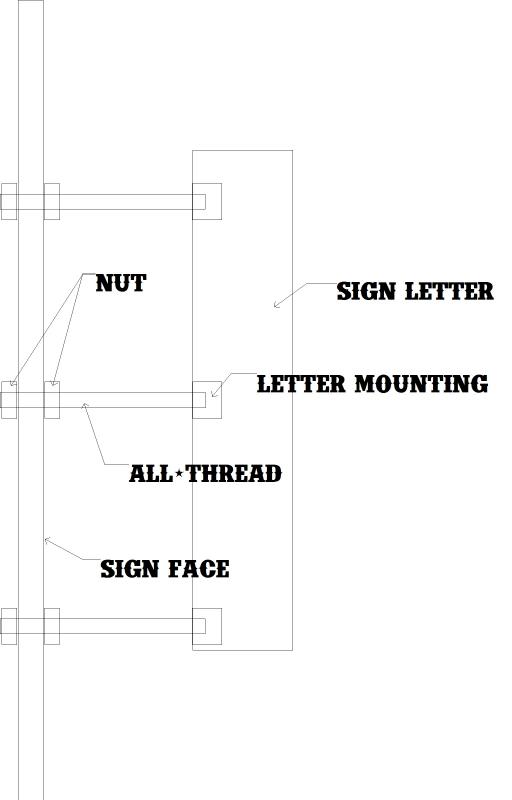

If you get the letters from Gemini make sure the get a pattern from them too. I'd stud mount from the rear as well as use silicone.

If you On Gemini's web site and under sign components you will find mounting supplies. Most everything is listed there. I would stud mount them through the Dibond if it does not have to be flush with the building. The template that Jill suggested is a huge help and a time saver.

The Gemini letters (plastic) come with mounting points made into them for studs to go into. You can use the threaded rod from these points and go through the dibond and put a nut on it. The template we have mentioned will come with the letter shapes printed on it properly kerned and also have the location of the mounting points marked on it so you can put the holes in the correct place. If you look in the hardware section you will see pads with studs sticking out of them. These are used to bond the letters to substraights.

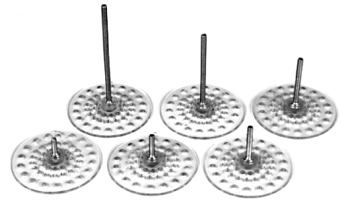

Attached is what you will want to use if you cant have any hardware on the rear of your sign. attach using a good quick set epoxy.
You can find these under sign components and install supplies on the Gemini site.
Attached is a rendition of stud mounting.

I think i'll be doing the pad mounting since it's a simple glue and stick.
What brand/model adhesive should i use to attach it to the dibond? Reason i am not putting it into the wall is the letters are red and black and the wall is forest green.

I use pad mounting for all my Gemini installs. You will still want combo all pads, and drill for the stud. That way you have a center point to locate the pads, and they won't slide.
