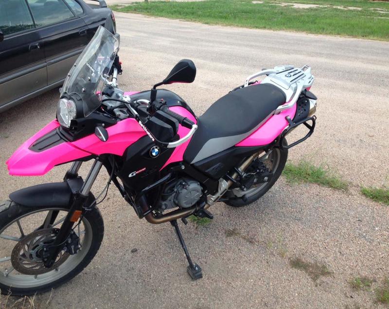

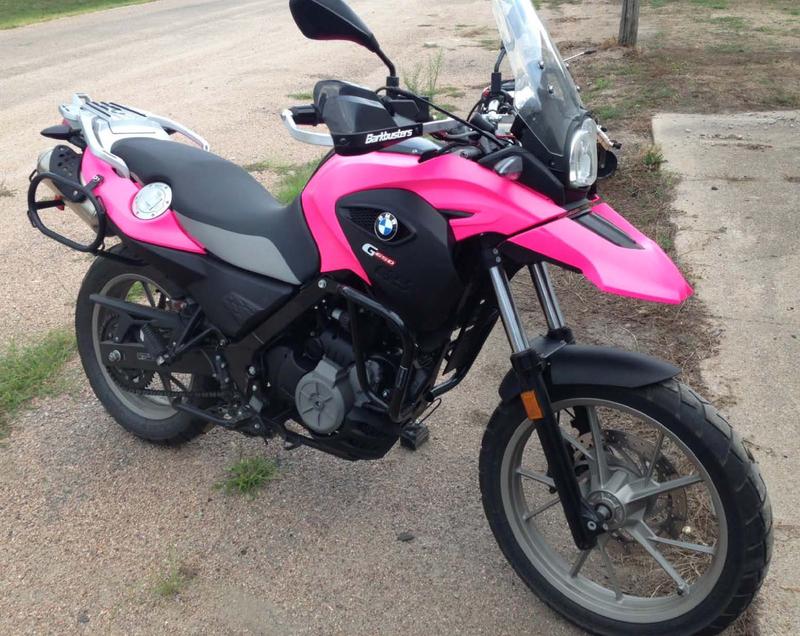

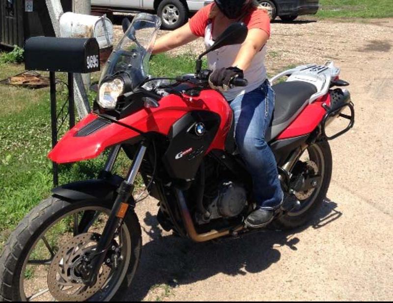

I just finished wrapping a BMW G350 GS, taking the red to pink. It turned out pretty good, but had some issues with a few curves and one spot was stretched a little too much (IMO...however, the customer loves it!) All I had to work with was a plastic squeegee, a heat gun and an exacto blade. Has anyone else had experience with his type of job? Maybe tools that would expedite the process? It took a lot longer than I originally thought, but it was also a learning experience for me. I went with 3M 1080 satin fluorescent pink. Pretty easy to work with (I did have minimal bubbles, but am expecting them to work out with sun exposure) and will definitely use it on future jobs. Also, opinions or criticism on the finished product is welcome!

Nice job.
We've wrapped a few bikes.
Never made any money doing it though..

I definitely didn't make anything on this once I figured in time... but the experience was worth it. For the first one anyway. :)

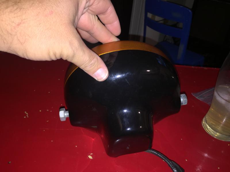

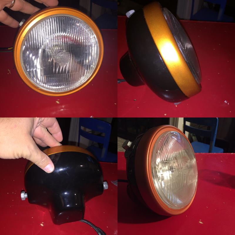

Great transformation! Bikes are crazy tough. I'm doing a few things on my cafe project and vowed to do it without seams... Attempt #1 on the tank needed up with a seam and after 4 attempts on the headlight housing...I have a small seam (that thing isn't quite like a basketball...more like the Death Star with the concave areas residing in a couple spots). Great for testing your patience. Another attempt on the tank will be made over the next few weeks as I've changed my color scheme.

Here it is, the headlight anyway!
