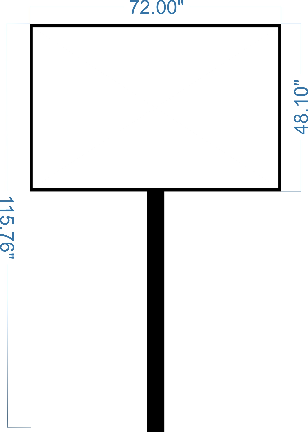

We have an opportunity to build a small pylon sign. It is for a single tenant and only 9.5' tall. Sign is a 6'x4'.
**Backstory - I have basically said no to these projects for the last 5 years. We started as a print / wrap shop & few years ago we started
doing face replacements and building cabinets and things. We have done some freestanding signs using wood posts. I feel we are ready to
move into something a little bigger. This is a walk in the park for most of you on here, but to us we want to skip making simple mistakes.
I am starting my information search here as you guys are always extremely helpful & knowledgable.
Questions
1) Is there a resource somewhere that shows the entire fabrication process?
2) Best way to mount to a single 5"x5" square post if building the cabinet from EX extrusion?
3) Is there anything I should know that I am probably not thinking of in this process?

2. weld a saddle out of 2" steel angle, paint it, then bolt it into your (presumably) aluminum cabinet. One top and bottom. We'd make the opening at around 5 3/16". Weld to pole on site.
3. Lots of factors here, particularly engineered footing since you're up north. As far as how to build the cabinet in an easy to digest manual, no chance. I have minimal documentation for the extrusion we use, but eve it has a lot of information missing.

You probably won't find a manual anywhere. we build pylon signs all the time at our shop. We are in Canada, so i'm sure we have different standards for constructing such things. Normally we build the sign can out of sheet metal, angle iron and aluminum extrusions. As far as attaching to your pole, there are different methods. Usually the pole will have top and/or bottom plates welded to the pole and the can is "bolted" on for easy removal and/or servicing, but we also have done sleeve throughs, so it all depends. Are you planning on direct burial for your pole or a concrete pier with anchor bolts? Concrete peier with anchor bolts, you will have a baseplate and support gussets welded to the pole, with direct burial usually you jsut have the plate at the top of the pole connecting your sign header. Usually a new pylon sign will require permits from the town/city and/or state/province and an engineered structural drawing for approval by an engineering company prior to construction. But like i said, maybe if your american, things are done different down there. Best of luck!

We are good on permitting & the engineering / stamp is not required by the municipality based on the height. I do have a general understanding of how we should go about this in regards to almost everything other than the internal mounting of the cabinet onto the pole & the use of EX extrusion for the cabinet.

1. Local code and permitting requirements. Preliminary site inspection. Make sure you can install the sign where you want to and get a dedicated power line to it.
2. Engineering. The sign will need to be engineered for the soil conditions and wind load whether a stamped drawing is required or not.
3. Welding. I have been doing this for 40+ years and have encountered far too many welding failures.
Building and installing the sign will depend on your equipment and expertise. Outsourcing is a good way to go unless you have a fully equipped fabrication facility and a proper paint booth and paint application system. A small sign like this could be buried directly, but pouring a foundation and using anchor bolts will be easier for most shops. Transporting a long tube and supporting it while the concrete cures could be a problem.
You will need .6 cubic yard of concrete. I would dig it 4' x 2' at 42" deep (frostline in my area) and put the whole yard in the hole (many redi-mix companies will deliver a yard, most have a two yard minimum, so you will be paying for the concrete anyhow). An augured hole (for direct burial) would need to be 6' deep (assuming a 24" auger; 10' deep if using an 18" auger). I would use a 24" auger if I decided to go that way and save money on steel (15.5' long tube rather than 19.5' tube) and handling costs (a 1/4" x 5" x 19.5' square tube would weigh 300 lbs.). You might consider a 1/4" x 3" tube and build a pole cover, which I would likely do anyway for the improved appearance (note: I am not an engineer, these are just estimates based on experience. Do your own calculations.)
